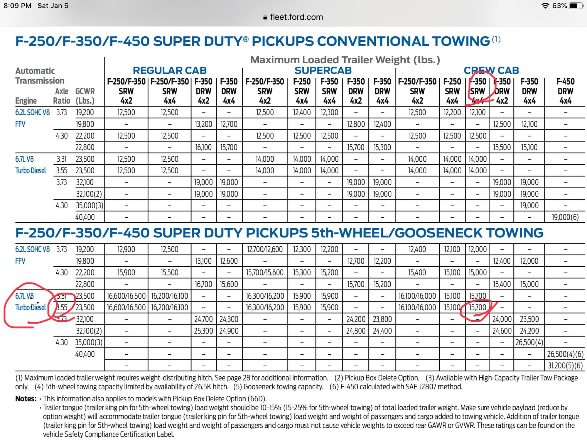

Last year I had overheating and power issues with my 2015 f350 srw 6.7 superduty king ranch with 355:1. I was told that it would pull my 40’ 5v at 17500 without a problem. Going over mountain passes I had power and overheating issues. Truck had less than 38000 miles. Even descending with the exhaust brake the transmission would not shift into higher gear as it leveled out of the grade. Has anyone had these issues? Am I expecting too much and overloaded?
The 2015 RV and Trailer Towing Guide indicates that you’re overloaded, perhaps by several thousand pounds. To complicate matters, the maximum trailer weights are based on the XL trim level, no unnecessary options, no cargo, and no one on board except for a 150 lbs. driver — in other words, all of the fine print stuff. Higher trim levels, other options, realistically sized driver and passengers, and other cargo reduce the maximum trailer weight spec. And, cooling capacity is reduced by thin air at high elevation.
Less cargo, emptying the holding tanks, lower elevation, lower transmission gears, temporarily turning off the A/C, and slower speeds when climbing may help. Regearing the axles from 3.55 to 3.73 may be a solution to consider.
