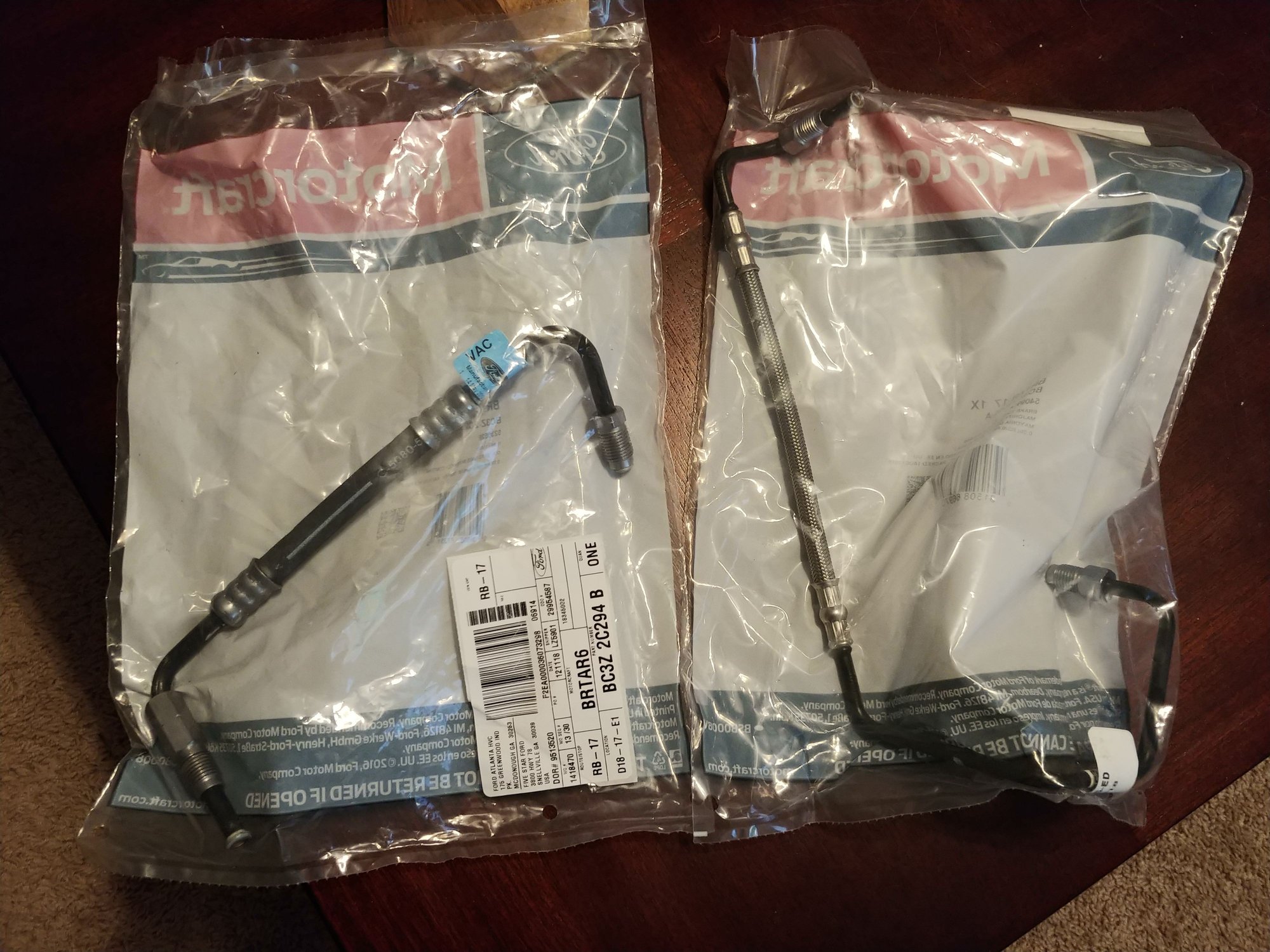

I have these two hoses that the Ford tech told me to replace before I picked it up, he said this is what they were going to do next, but they wanted $600 for the install. Are these what you are referring to?
BC3Z-2C294-B
​​​​​​​BC3Z-2C295-A

I have BC3Z-2C294-B and BC3Z-2C295-A
Lines that the tech at Ford told me to replace. They seem to be the feed and return lines from the master to the abs. One is steel braided the other is rubber but very short. I will install them tomorrow and report back.

I replaced both lines from the master to the abs today. It did not change anything. If I pull back on the pedal with my foot after leaving every red light/after every time I press the brakes then they never lock up.
