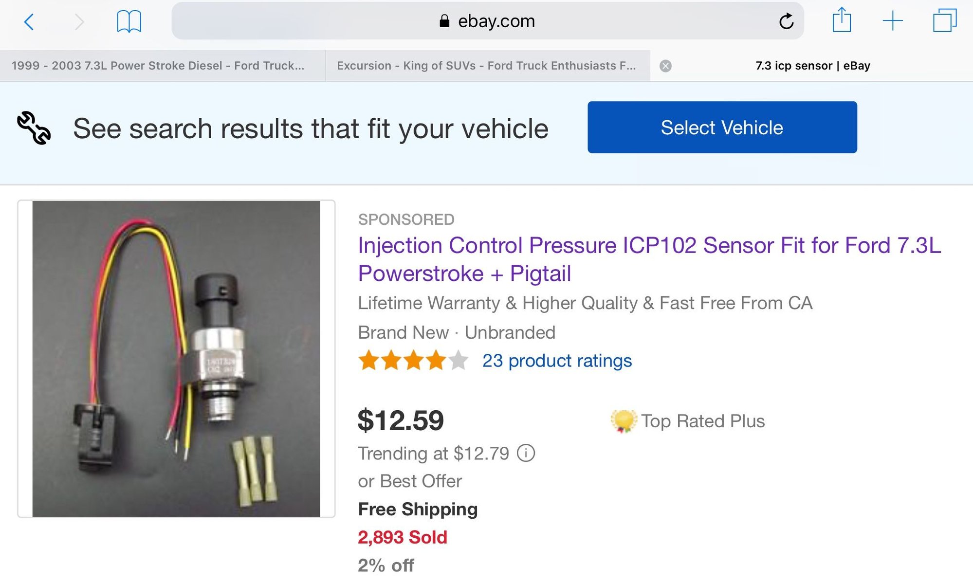

Recently replaced my ICP with a motorcraft and it got me to thinking about a spare since I spend a good bit of time in Baja far away from a parts store, ordered a $12 Chicom off of eBay figuring the seller has sold 3000 of them and still has a 99.4% rating they must work for at least a little while,
So my question is, if you have run one did it last ? And more importantly was it accurate ? did you check the PIDs and verify it reads at least about what you would expect to see ?

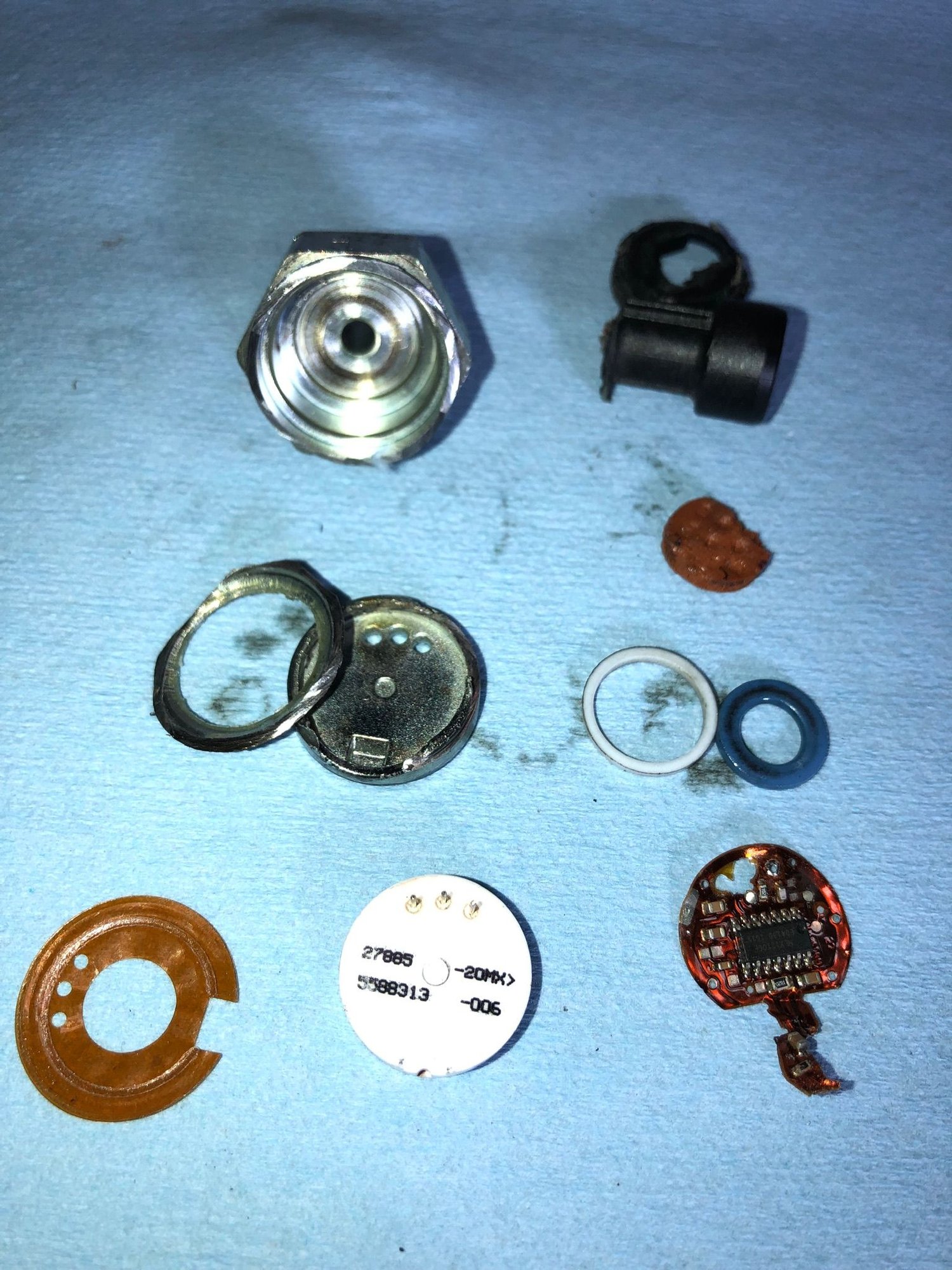

Being the curious type, I cut open my motorcraft ICP to inspect the components, I think I will order 2 of the Chicom. 1 for the glove box and a second to cut open and compare to these motorcraft parts.
componet wise it’s pretty simple.
metal housing
gaskets
circiut board with chip MLX12106R E04136 1611
ceramic pressure sensor 27885 -2
gaskets
All in all it is a pretty simple, ceramic disk is a variable capacitor that measures the deformation of its plates capictance, the chip set amplifies that millivolt diffrence into a standard automotive 0-5 volt signal

I too, also live dangerously..whats your findings on the failure part to allow oil into the metal prongs

The blue O-ring is sandwiched between the case and the ceramic pick, if it leaks then oil makes it way up into the circuit board and put the connector end.

I went fishing with the idea that, that blue oring could be had if a failed icp insued. Apparently, the icp didnt win the war when accomplishing such voyage...appreciate the info though

Thanks for cutting it up and posting the pic, never seen that before. Reps!
Maybe change the title to include a reference to the pic? Make it easier to show up in searches.
I'm going to get one as a spare too. Do me a favor and confirm the harness is the same. The Chinese ICP comes with a pigtail, be good to know it's same fitment as the OE ICP.
