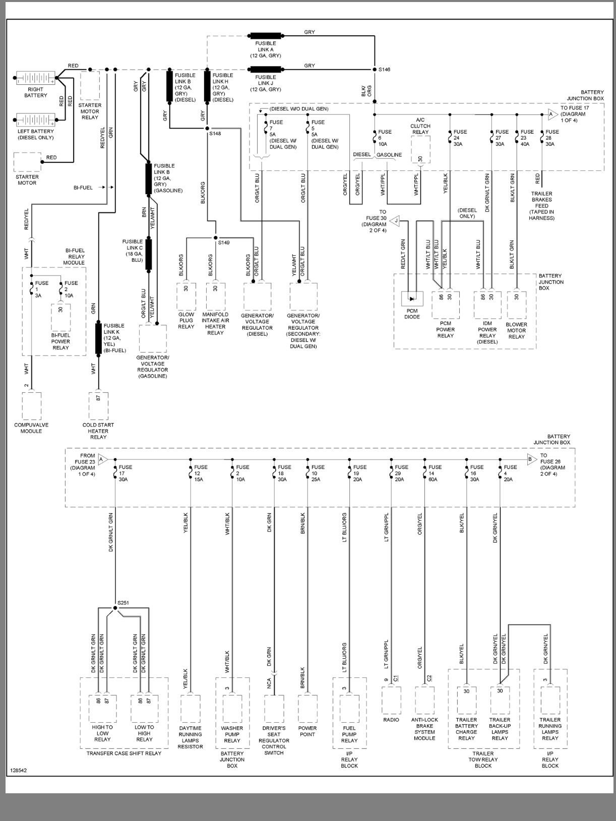

Maybe this will help...

This one too...

Thanks Ill do some research on that and see what I come up with.
