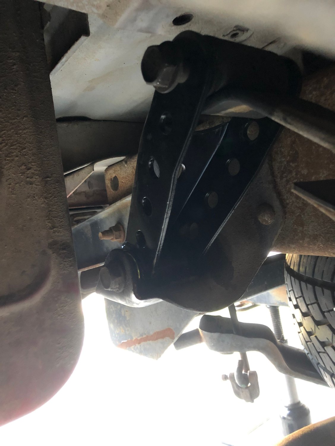

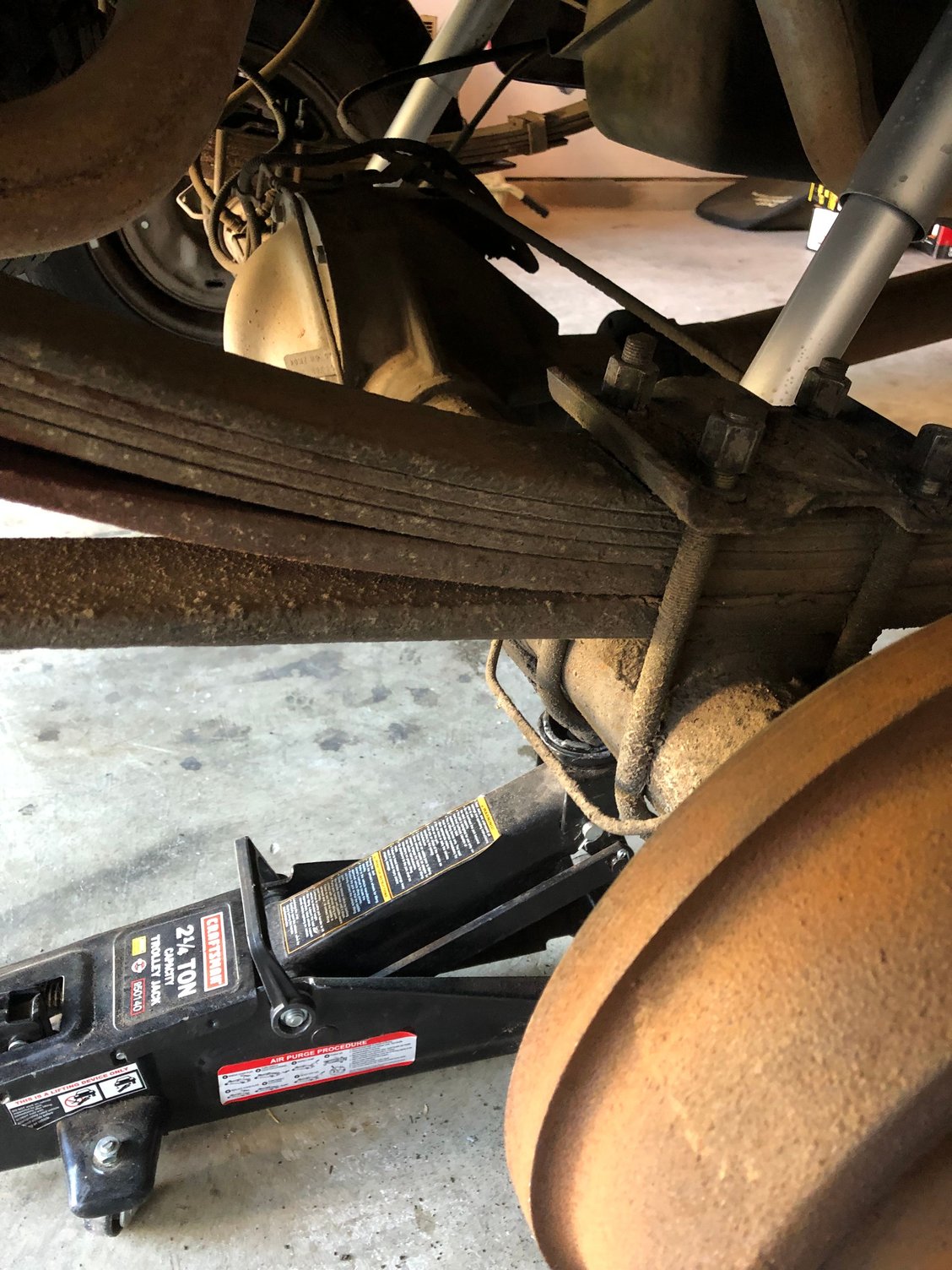

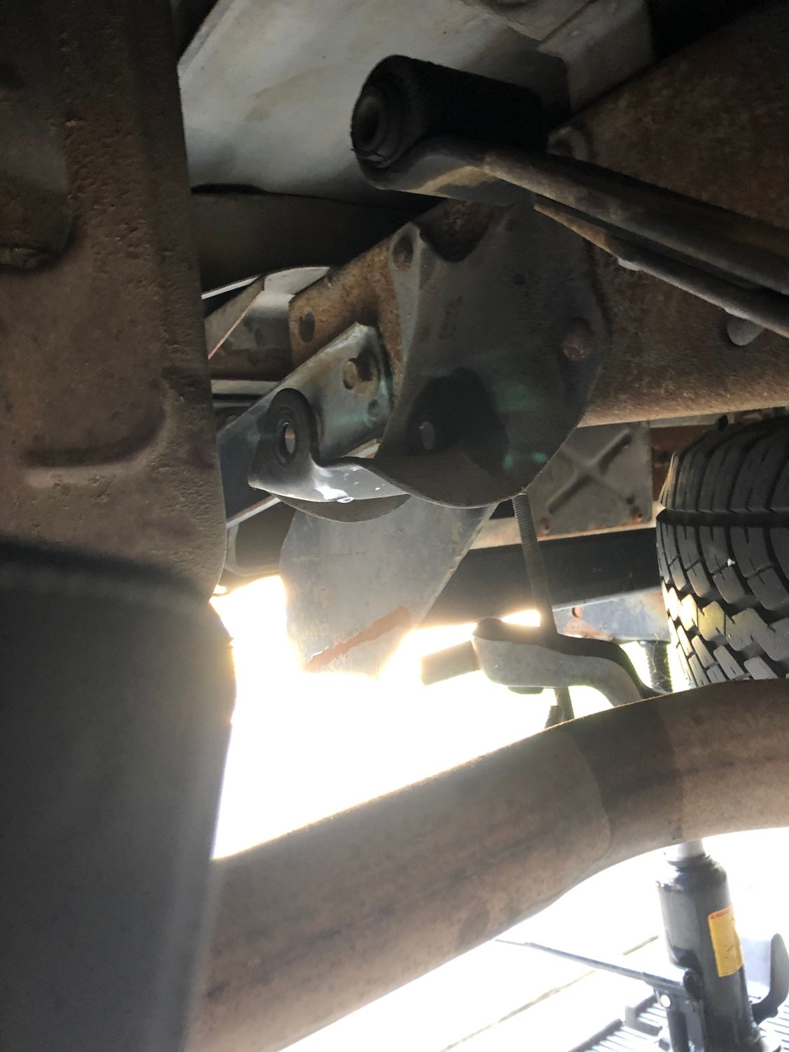

the main issue I ran into was the top bolt was put in inside out so I had to loosen the u bolts to get the leave springs to move outwards and remove the bolt. I jacked up the truck from the back using a bottle jack and that took all of the tension from the leave spring. Very easy. Took about 1 hour altogether.

btw, I did have safety stands on the body a bit farther up the truck. Had the truck fallen I’d still have about 3-4 inches of clearance. I normally jack up the truck, put the safety stands in and then lower it to make sure they hold and that the vehicle won’t be too low to where it could bounce and hit me
