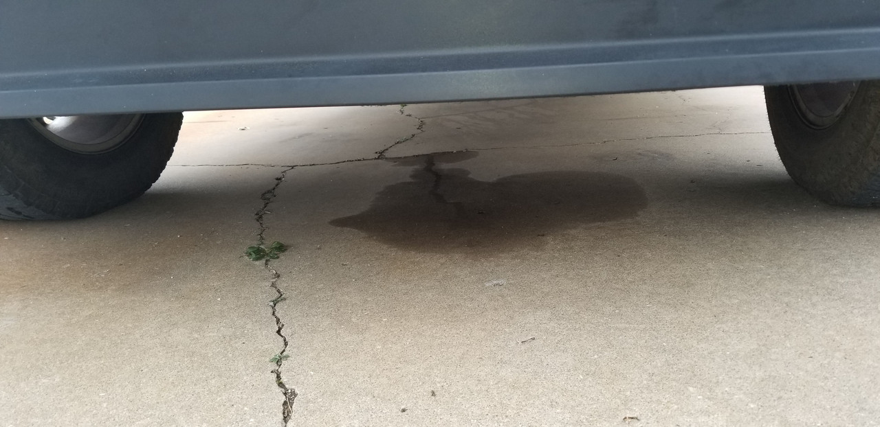

Deuce - Where was your water pump leaking from?
Walked out to start the truck this morning and found this.
Looking up from the bottom of the engine. Looks like it's dripping from the area above the lower radiator hose, which I assume is the water pump. I've also noticed an occasional slight whining sound as well.

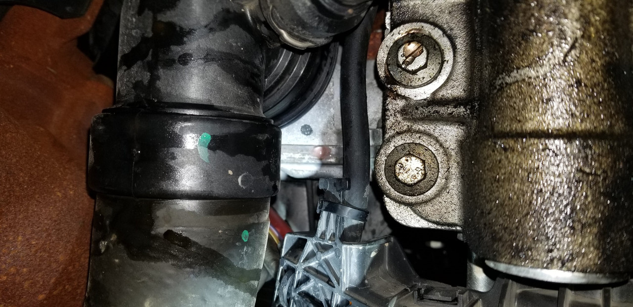

Here is what mine looked like for a known primary water pump failure.

Yes, that looks like where mine was dripping from. The drips followed all the suspension components before dropping on the ground so the point of puddle would vary. It looks like you might have an oil leak as well?
