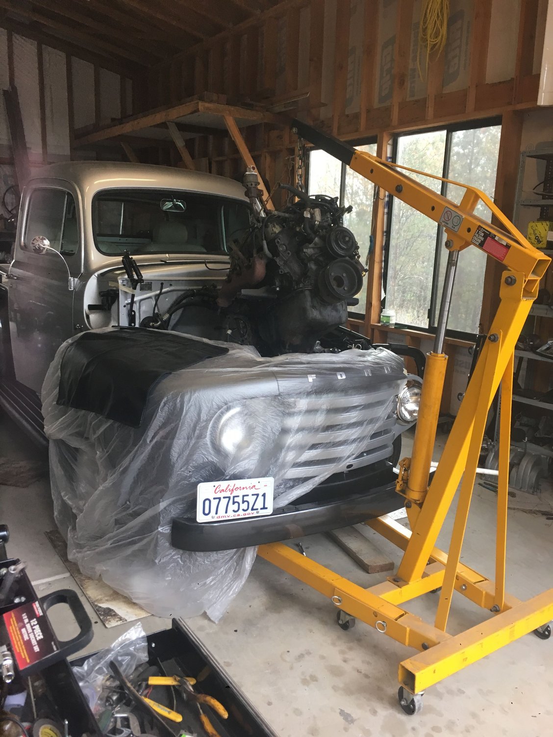

This is a good thread for me just got my 302 out today and going with a roller don’t know what I’ll get but must work with EFI
