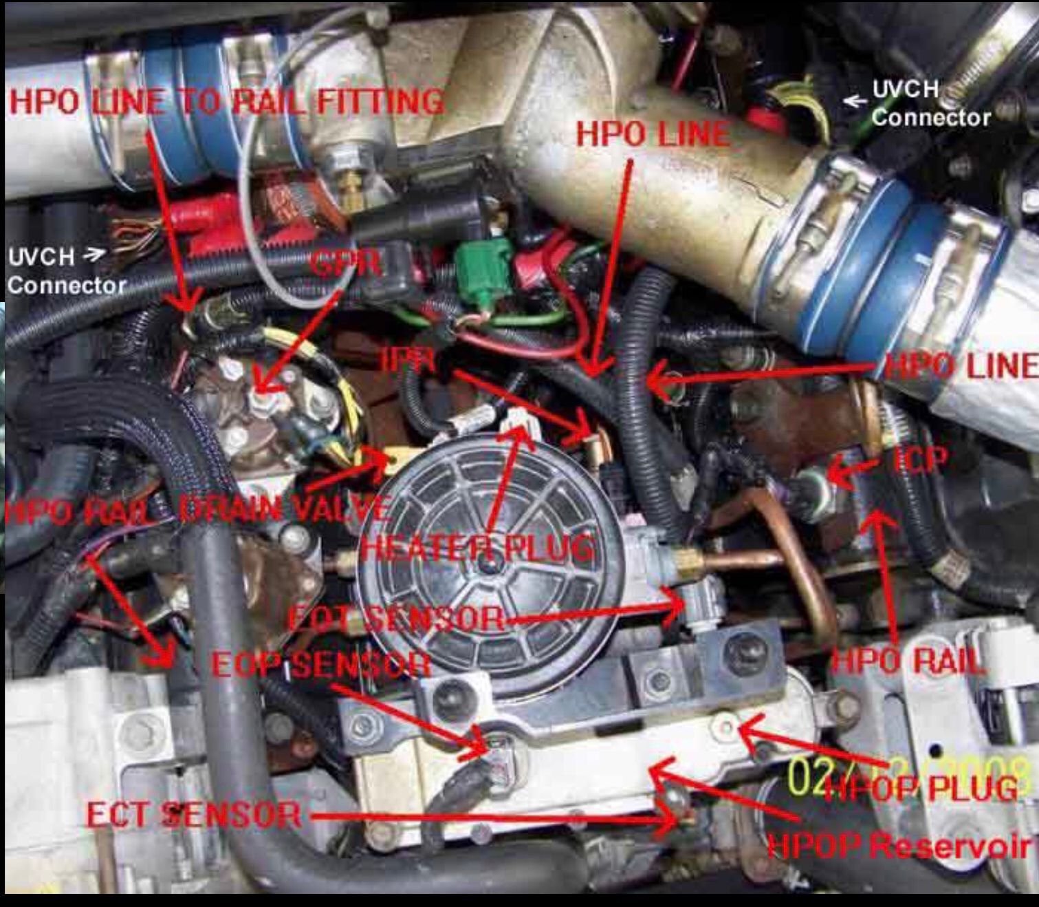

Definitely sounds electrical. Something which is easy do to and doesn't require a lot of specialized knowledge is to just start checking connections. Check the battery connections, grounds, etc. Check all the wiring harnesses for broken connections and rubbed and/or exposed wires. There's a big 42 pin connector on the driver's side (photo here) which can break and sag and allow the big harness to rub on the valve cover and cause all sorts of electrical gremlins.

I will tell him to do that! He said when it starts there is smoke/steam coming from left side of the motor (not the actual motor) he said thereís a plug that has some oil around it? Not to sure what exact part heís referring too

Pull the connector off the ICP and see if the electrical connection is full of oil, if it is you need a new OEM ICP, NO AFTERMARKET SENSORS.
