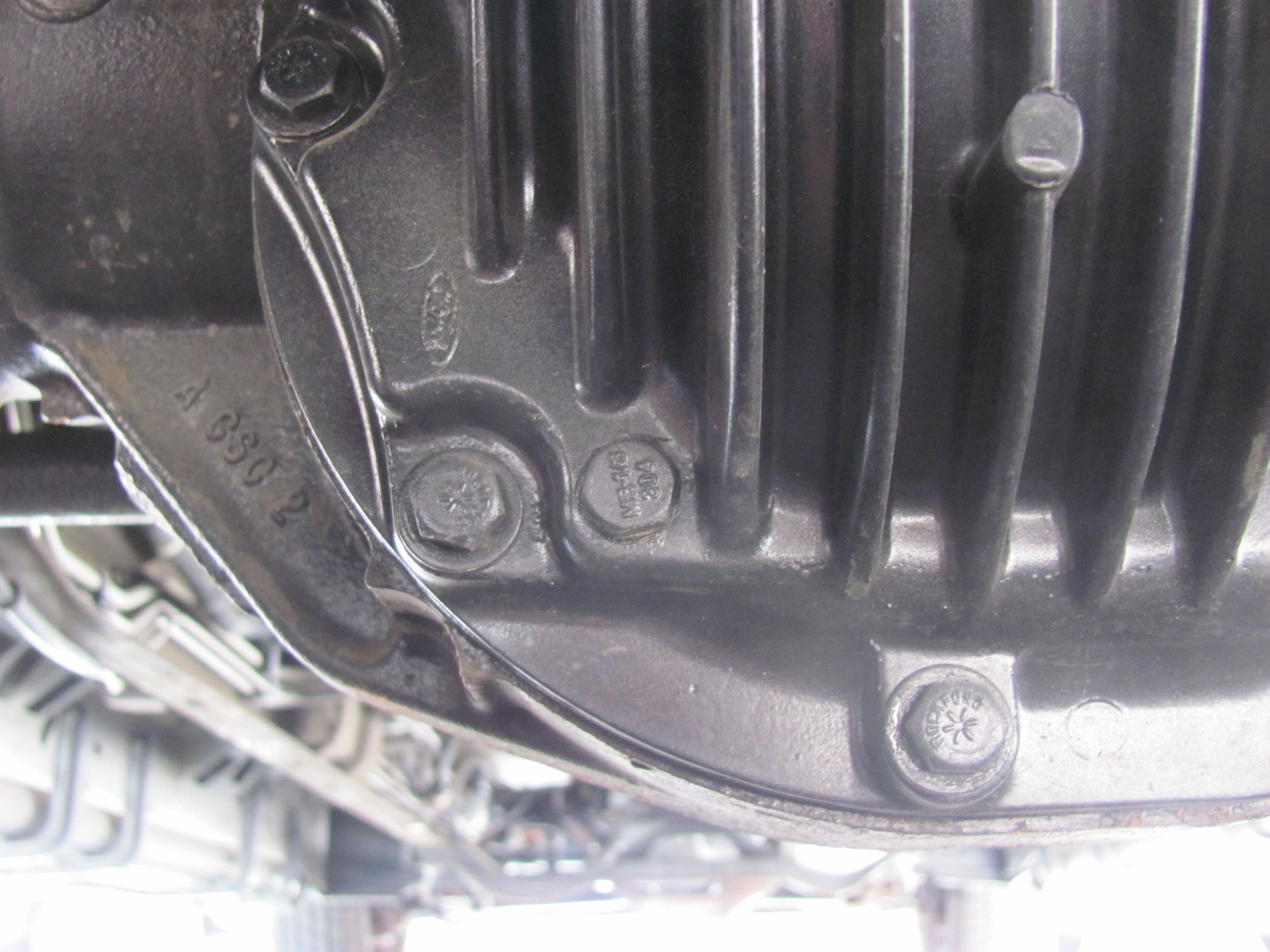

One other accessory that seemed worthwhile was adding the OEM aluminum differential cover from the 2008+ F250.
Ford must have had a good reason to add it, around $60 on ebay, Ford 8C3Z-4033-A
It needs (12) 5/16"-18 x 1-1/4" bolts.
A Lube Locker Ford 10.25/10.5 differential reusable gasket is nice.
I tapped the cover for an 1/8" NPT drain plug before installing.
