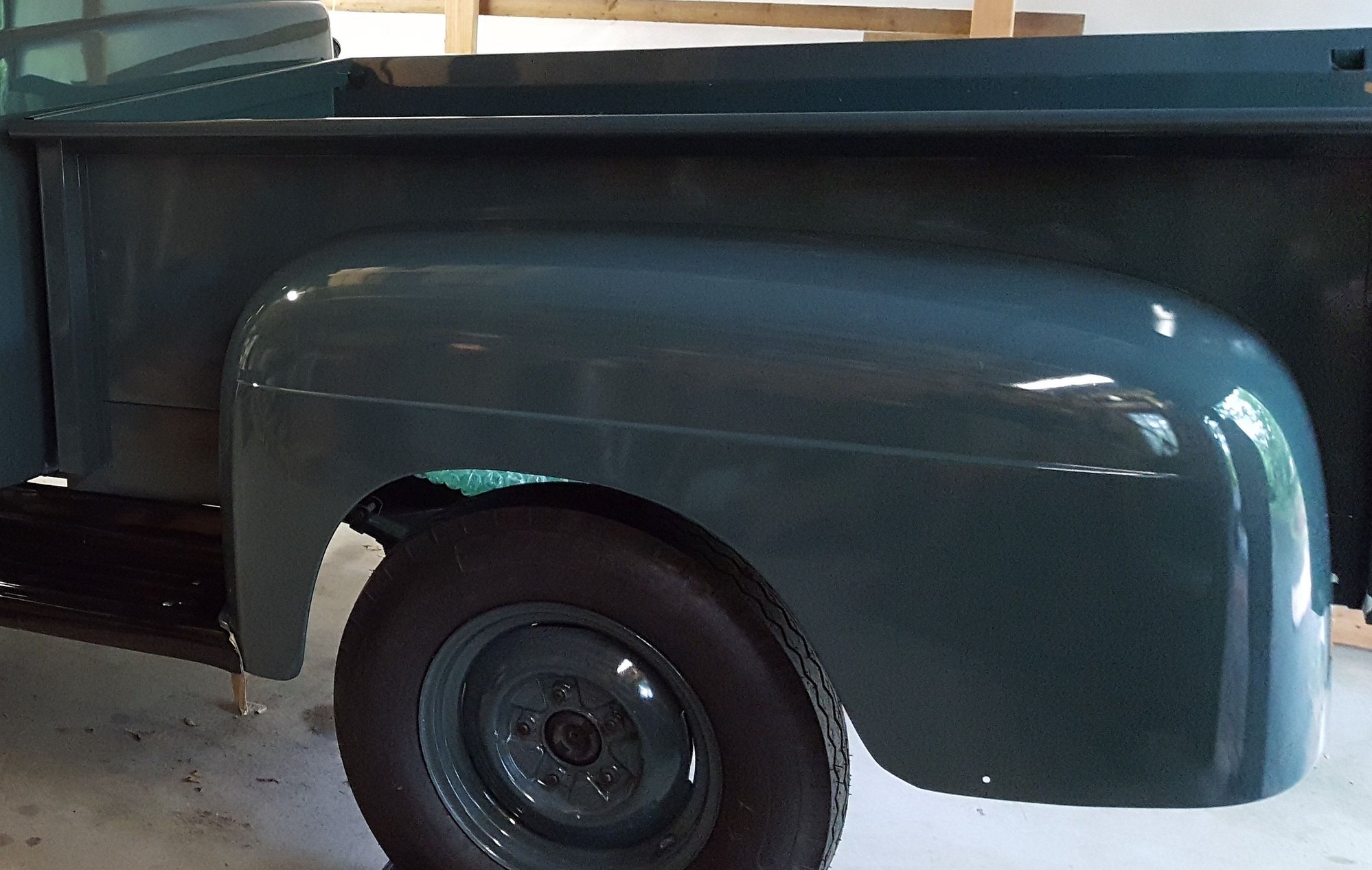

jerry_s bought all four fenders from DC and just painted them and bolted them up, take a look https://www.ford-trucks.com/forums/1...-the-54-a.html
