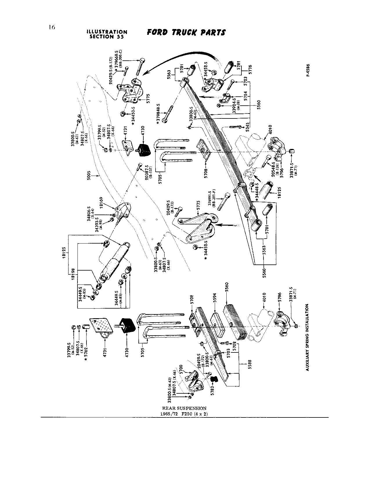

Would this be a typical rear leaf for 70 F250? Seems like a lot of leaf's. New member thanks for the help

TWO different types of rear springs. Your truck has extra leafs added.
Upper pic: 1968/72 F100/250 2WD with Flex-O-Matic rear springs. Notice the 5A709 compensator at the rear and its 3 bushings.
Lower pic: 1965/72 F250 2WD without Flex-O-Matic.

It has Flex-O-Matic rear springs, note compensator.
Originally, it came with a 6 leaf spring pack, but there were three different load rates, depending on what the Gross Vehicle Weight Rating was (6900 or 7500 or 8100 lbs. - stamped on the Warranty Plate).
There was also an optional heavy duty single leaf spring.
