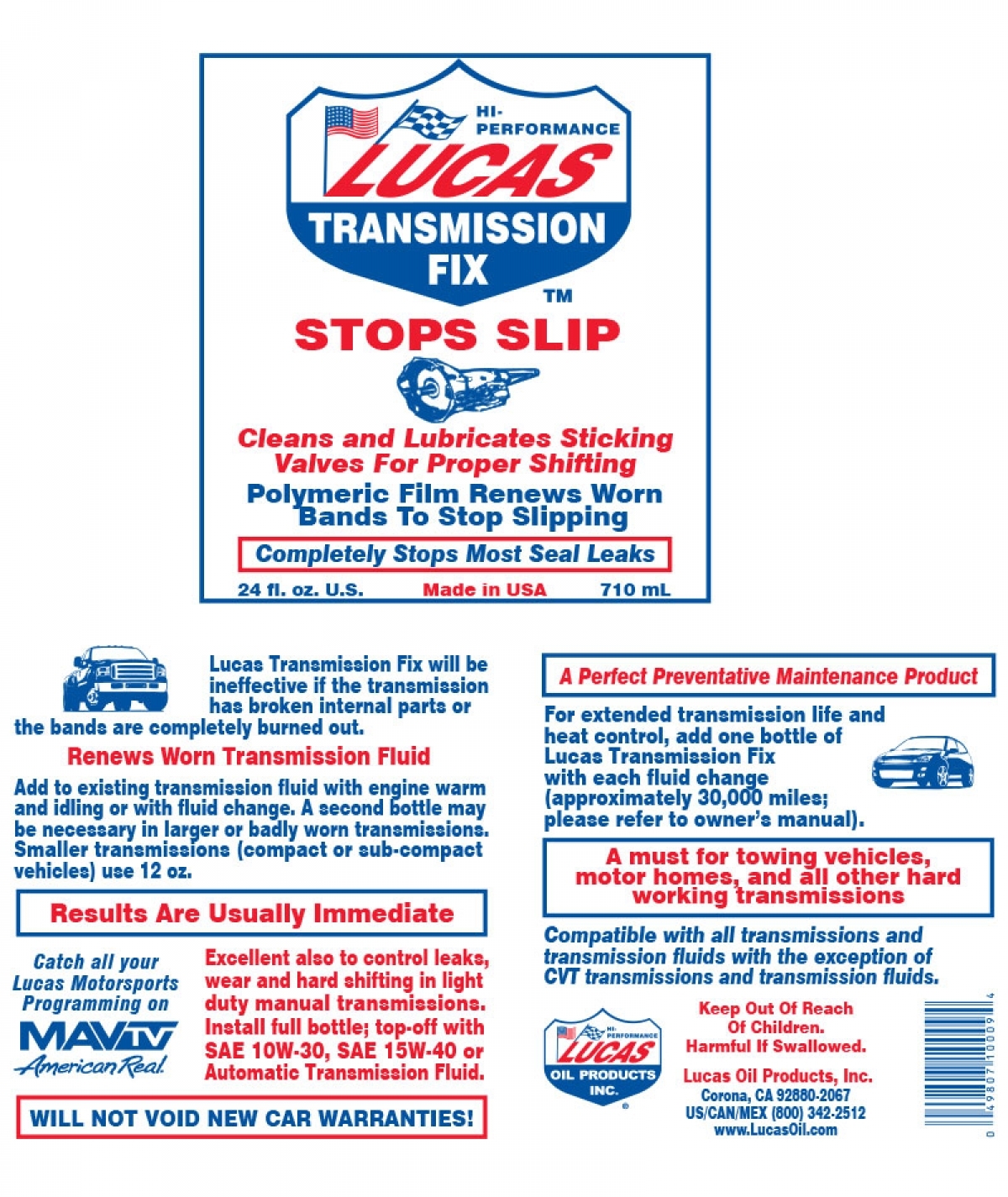

I've got a Mag Hytec transmission pan with the magnetic drain plug, extra capacity, and the cooling fins. I like to drain & fill. Then disconnect the transmission cooling line and pump out the old fluid a few quarts at a time, as I refill through the dipstick tube.
Lucas Oil Transmission Fix is a controversial product. Some people love it. Others will warn you to steer clear.

I would not be putting LUCAS or any other crap in the transmission. It is suppose to be MERCON V in the older trucks and MERCON LV in the newer ..The stuff in LUCAS is not necessarily a good match for Trans FLuid.
and this is an ENGINE OIL post. If you want to argue about TRANSMISSIONS, you should start a new post.
