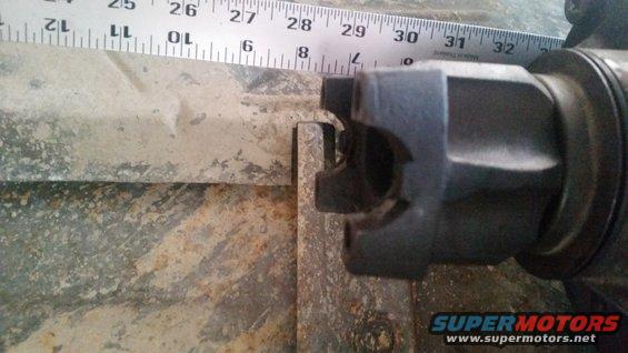

They were each changed about 3 - 4 inches.
Fortunately, for me, the 5 speeds came in the 80+ Bronco body style, so I was able to use the printed lengths online. I did measure with a straight edge, and they were nearly identical to the printed numbers.
Yours will probably need to be custom measured, since you're in a 79 body style. Also, it'll depend on which transfer case you have, since some are thicker than others.
Measuring is easy though.
Just measure yoke to yoke:
My rear driveshaft was 28.5" cruising/resting (which is what the driveline shop will want to know). Usually there's a few inches on each side for extra compression/extension when going over bumps, flexing, etc.
