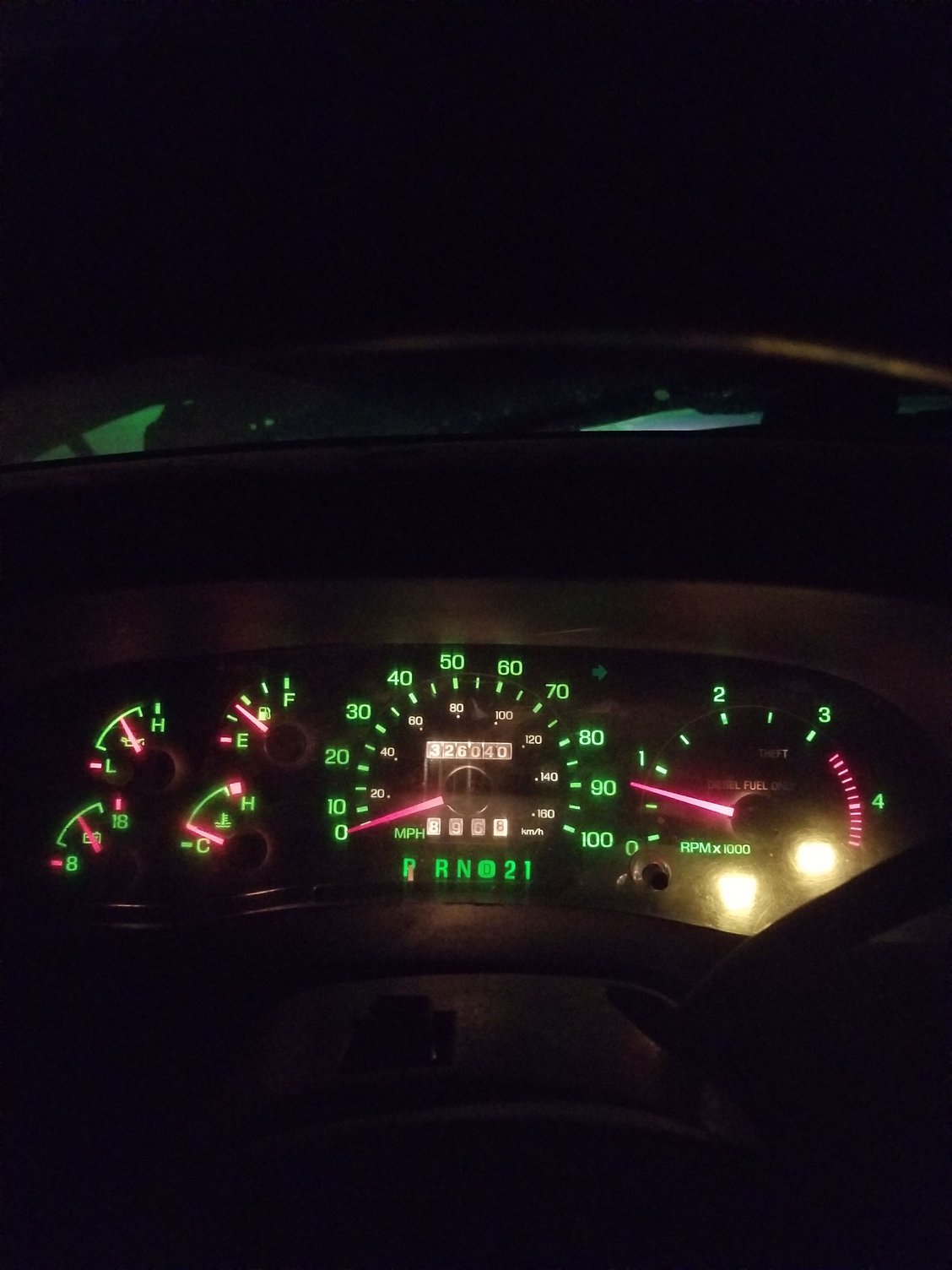

Idling on its own just about 15 sec. Then died
check engine light is on and abs light is on in pic.
