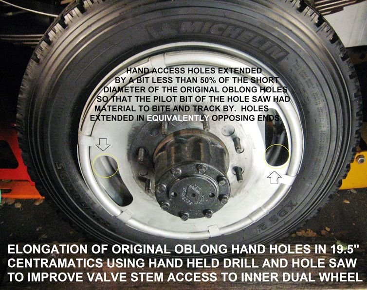

If you could post a picture sometime of how they fit and how you check the inner dual I would appreciate it. I am considering these but am concerned as it is already a pain to check pressure. (looking for this specifically for the 19.5 dually wheels)
Certainly...
