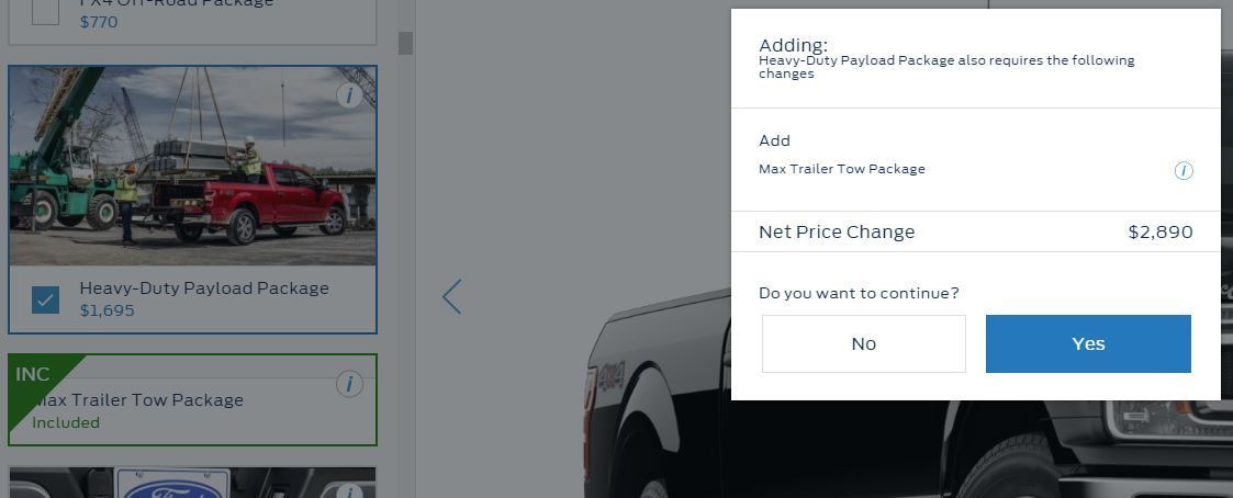

I believe the reason you can't find one, is because they don't make it. When I was ordering my 18, I wanted Max Tow + Max Payload. When the sales manager entered that into the order system, it kicked it out. I remember him telling me that it was one or the other, but not both (but I'm sure he really didn't know). But after the truck was ordered, I dug deeper and found that only 157" WB models can get Max payload and since I ordered a144" WB model could be why it got rejected.

Thats because HDPP requires max tow, so if he entered it separately it probably errored.

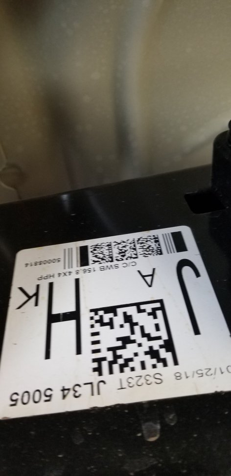

HPP Frame
Originally Posted by FORD1976 View Post
My dealer found one with max tow with 3.55 can tow 10,200 lbs but just trying to figure out payload. Itís also the 157 wheel base
That number is incorrect, the max tow trucks are rated for up to 13,200. But just remember the truck has to be equipped with 20" wheels or else there is no frame or spring upgrades. That is per the order guide.

Only way you are going to get higher is with a HDPP truck, which adds 800lb to the gross capacity to the truck and would bump the payload on the same truck to 2500-2700lb.
