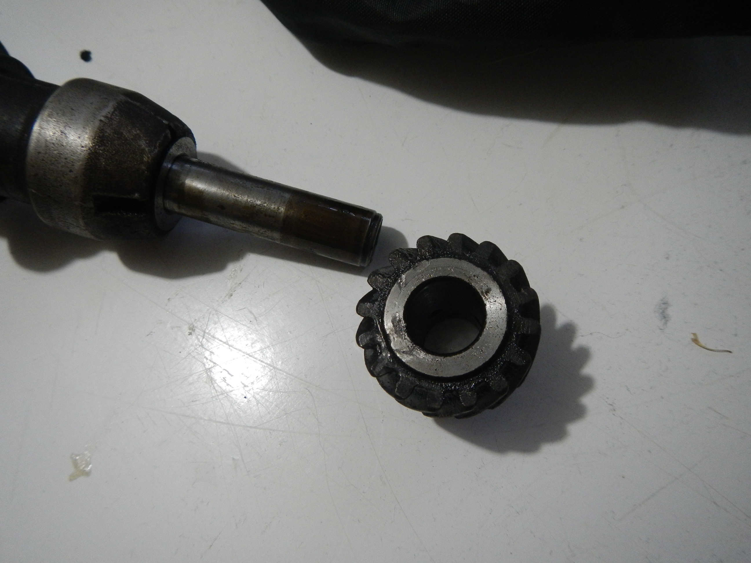

Found the problem after all: sheared distributor drive gear pin. Running out of gas was a coincidence. I understand this is a common problem (I thought these motors were supposed to be pretty tough...?) and have some reading to do. Wonder if my new oilpump had something to do with it. It's a stock Melling M74, not high-volume or high-pressure. I replaced the worn stock drive key (7.93mm = 5/16" in American units) with a standard 8mm (8.00 on my calipers) for less wear. Seems to fit the dizzy just fine, I can turn the oilpump with a 1/4" extension by hand, and there's the normal axial play. Still... any more experienced folks see a problem here?
Also, there are four holes in the gear shank. I've read that they come with one from the factory that's then drilled through. Does this suggest it's been monkeyed with?
Is this drive gear salvageable or is the damage (I confess: from removing it) too much? The corresponding surface on the distributor looks good, shiny, very fine circles. Gear wear pattern seems ok, a bit toe-heavy (towards the tip of the gears, but centered).
Distributor shaft radial play measured 0.006" on my jury-rigged test bench but feels a bit bigger. Anyway, it's enough to visibly affect point gap. I've been doing homework and leaning heavily towards a Duraspark 2 conversion with a brand new Motorcraft dizzy (can't afford DUI, don't trust Cardone). Will either of these below work? What's the difference between them?
