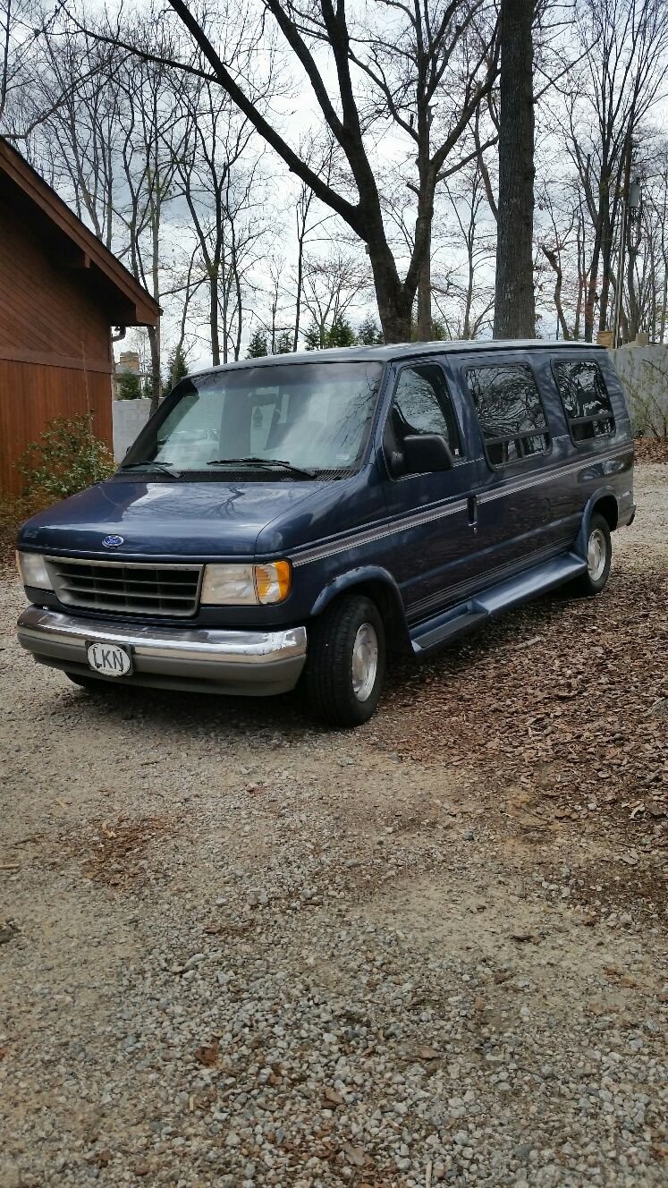

Hard to see in this picture. I had a '96 e-150 Mark IV conversion van, and towed a 2 horse trailer. I had to replace the rear springs and got the heaviest set - I think it was 4 leaves. It sat too high in the back. I would suggest 3 leaves if you carry a heavy load.
