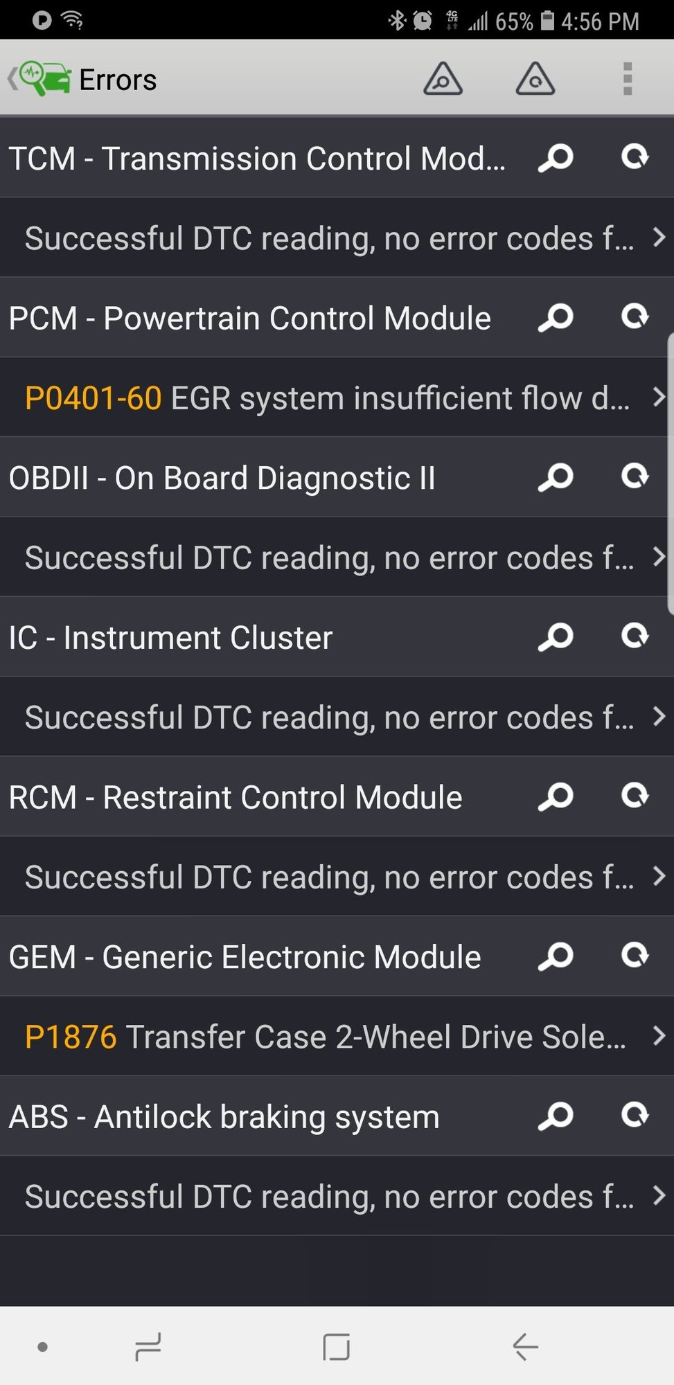

This is my current code. Which is the correct way to go with this situation? A bypass kit or replace the egr cooler? I have replaced valve in may and yesterday replaced it again because there was an issue on electric side of valve even though it opened closed fully by manually opening and closing after I pulled it. What is the benefit of a bypass kit or replacing with a new one?
thanks for your guys dedicated help!!!

You might try pulling and cleaning the iat2 sensor as they get clogged with soot from the egr. If that doesn’t fix it, you likely have a plugged egr cooler. If you live in an emission testing area, your best bet is to install an aftermarket tube style cooler (bpd or similar) to keep it emission legal. You can also purchase some tuners that will command the egr to stay closed to prevent all the egr exhaust crap from entering the engine during normal driving (off-road of course) and then return it to stock when you put it back on the street and/or go to a smog test shop.

A P0401 can be a stuck EGR valve or even be a bad EBP or IAT2 sensor.
Seems like more troubleshooting is warranted as packagerjr is suggesting.

Yeah, last one I worked on the code went away when I cleaned the sensor. Could be a number of things as the insufficient egr flow is just,reading to see if ait2 sensor is heating up when the egr valve is commanded to open. Could be dirty sensor, bad sensor, sticking or bad egr valve, or plugged egr cooler. Try cleaning the sensor,and go from there.
