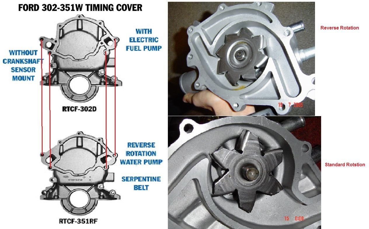

I still don't understand how a standard rotation pulley fit a reverse rotation pump since they have different bolt patterns so they can't be mixed up.. You have to redrill the pulley to make it work. Here's a picture I found showing what I mean.

NO --- I got a 1967-92 timing cover oil dip stick oil plugged and converted to a mech fuel pump , rear sump pan----- the Pump I had to use to match timing cover was a 1983 Mercury Cougar --- STANDARD rotation --same bolt pattern for cover and pump 4- bolt pulley has the one took off that was a REVERSE rotation---

Here are the pumps used one on left REVERSE--- wrong one sent by vendor--one on LEFT --STANDARD--correct one

I think some of the issues is you spec'd an 83 Cougar application for the water pump, they had reverse rotation pumps. In 83 the only the trucks and the Panthers (Crown Vic Grand Marquis and Town Car) had standard rotation pumps on the 302. Everything else was reverse rotation. For serpentine systems IIRC the only small blocks to use the standard rotation pump was the Panthers, 302 till 83-84 and the 351W till 91.
