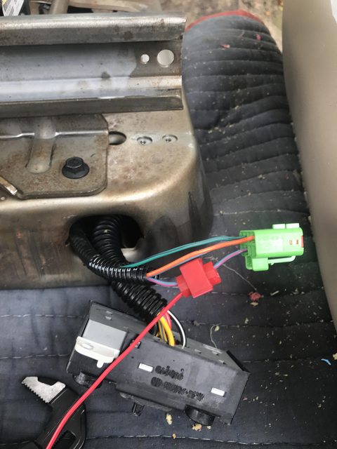

I used Dorman 628-040 when I refinished my seats with leather from the Seat Shop. I believe I had to fold a portion of the bottom seat heater over on to itself in order for it to fit properly. I spliced into the factory wiring after finding the 12 V signal I was looking for. These Dorman seats come with a switch for a high and low setting and only needed a 12 V input. So I left my original switch in it's current position since I needed/wanted to use the provided 2 position switch. I mounted it on the side of the seat further below. These work very well and get uncomfortably hot on the high setting at times.
Attachment 284936
Good luck and just take your time. Hog rings are annoying. Make note of how everything is routed near the hinge during disassembly so it can be reassembled properly.
