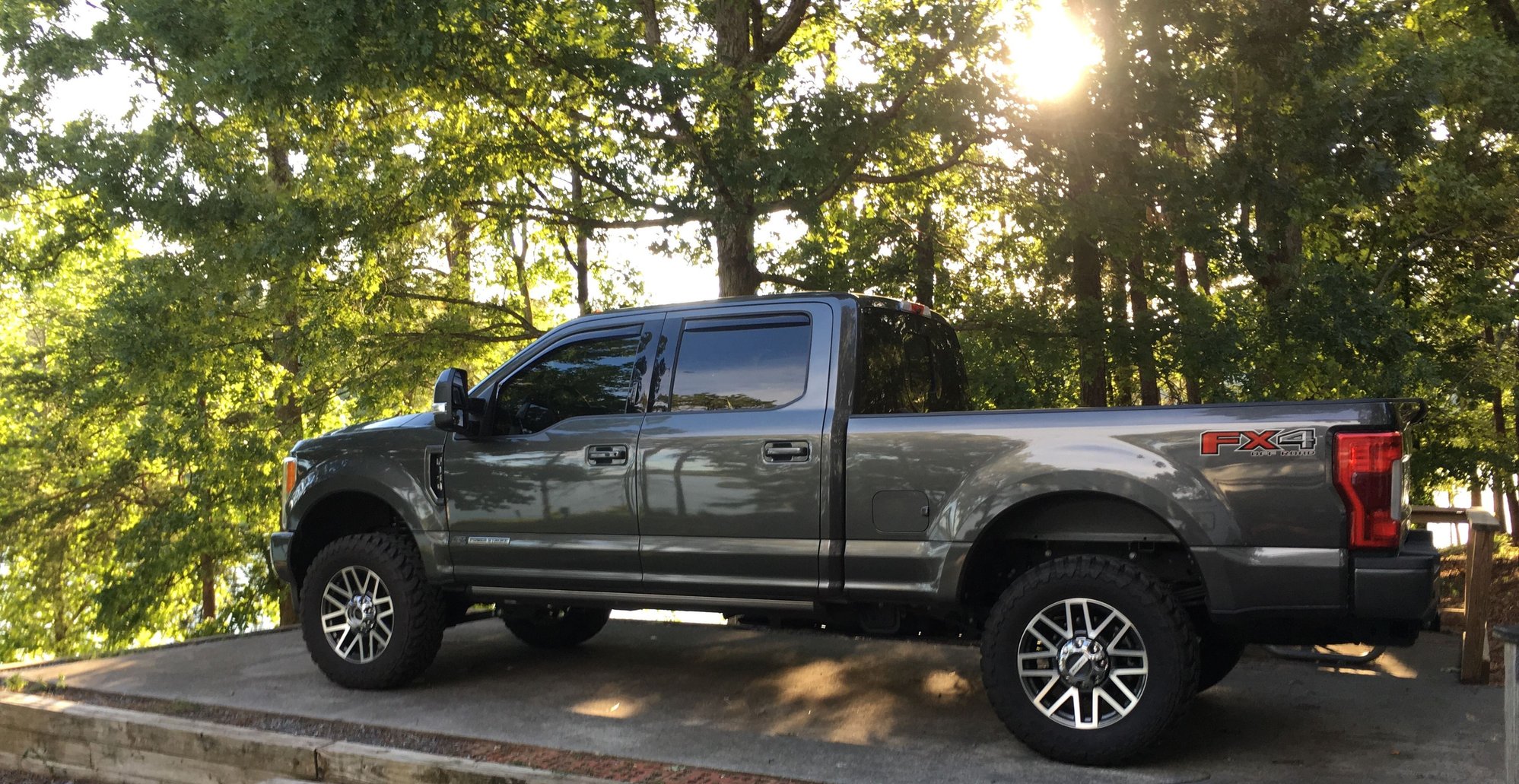

295/65/20 Toyo MTs. The 295s are the perfect size as they will fit a non lifted/leveled truck, but still have enough height to look good under a leveled truck. (They measure out right at 35.5"'tall) Plus, they have a 4K weight rating.
