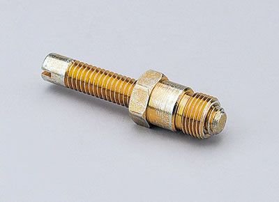

Originally Posted by EllieMae94 View Post
The balancer I used was new, but like you said, it's possible it shifted and doesn't show an accurate reading. How do I go about using a positive stop to check for this?
Thanks very much!
Buy one of these, or smash out the porcelain of a spark plug and weld a bolt into it. They thread into the spark plug hole, then you rotate the engine by hand clockwise til it hits the stop and mark the balancer at the tab. Then by hand counterclockwise til it hits the stop, mark the balancer at the tab. And half way between the two is real TDC.

The firing order is the same for the 302 that came out of it (1994) and 351 (1996) that went in. I was unaware of that piston stop tool, I'll be sure to pick one up. Also, I can check for air leaks using the method you describe above once I disconnect the O2 sensor that Paul suggested. Thanks to everyone for all their help!
