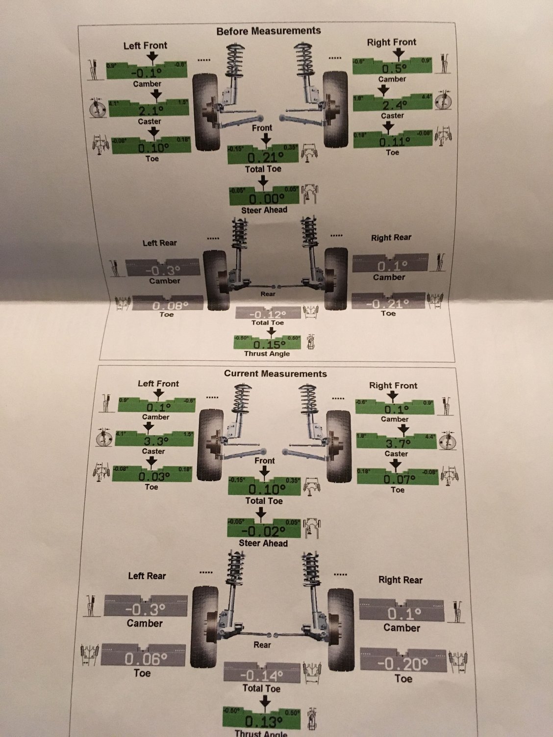

Old 07-09-2018, 03:31 PM
Josh315
Josh315 is offline
Join Date: Apr 2018
Posts: 19
Josh315 is starting off with a positive reputation.
That's where I am sitting after the Carli 2° cams and my truck drives great.
Carli Ford Caster Shim
Old 07-09-2018, 04:05 PM
TXSD6.2
TXSD6.2 is offline
Join Date: May 2018
Posts: 323
TXSD6.2 is starting off with a positive reputation.
Thanks, Josh! Your alignment looks like what I'm aiming for. Good to know that 3.9-4 caster can be had with just adjusters.
Which leveling kit do you have installed? Do you have a track bar relocation bracket or adjustable track bar installed with it?
Thanks! I hope to have my alignment squared away Friday.

I have the same 2 degree Carli shims with Carli's 2.5 in level.
My caster ended up at 3.6 and my truck drives perfectly. Very happy at that setting, mine is a 2017 F350 6.7.
Carli 2.5" commuter
