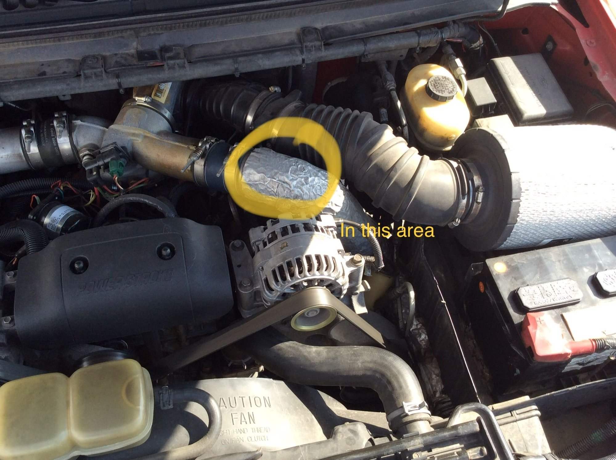

It’s been a few years since I’ve had my 7.3 sooo. Do you have a way to monitor data using torque pro or ForScan. We need to see if you have good HP oil to fire the injectors. You could also check to make sure the tin nut on the IPR valve is tight. Next would be to OHM out the 42 pin connection to see if you have a wiring issue to the valve covers. The valve cover connection under the cover is a known issue. The harness can come loose and lose connection.
Thanks,.for the info, but where is pin 42?
Marvin

How much oil was on the pigtail for the ICP? If it’s oil soak you could try to clean it with carb cleaner. Might be time to change the pigtail and sensor. The 42 pin is DS under the air filter tube to the turbo. It’s square with a lot of wires.
