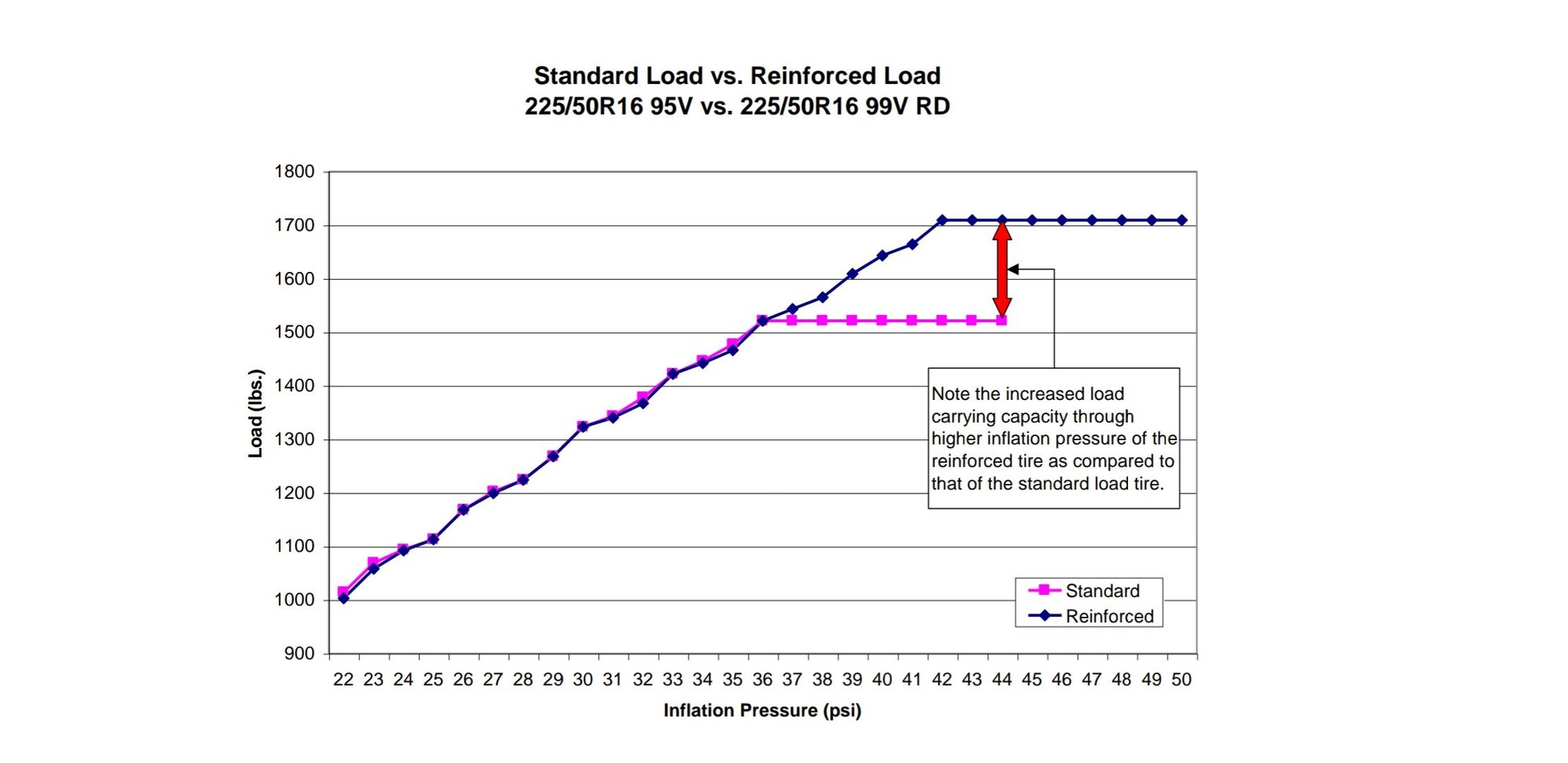

Originally Posted by Kaadk View Post
Yep, this used the bother the heck out of me when I had my Ram. Once the OEM tires needed replacing, I had swapped from running the stock P tires it came with to a set of LT tires (Max cold 80 psi, ran them around 65-70 psi street and aired up for towing). Every Single Time it went into the dealership for it's routine maintenance, the tires always came back deflated down to the door pillar's 35 psi recommend for the P tires I had replaced.
The load curve for LT tires is not significantly different except that it extends further. So, at modest loads, it is not inherently necessary to run significantly higher pressures than with lesser tires.
Pic is from Toyo Tires.
Hmm, are we sure we're talking apples to apples here? I went from P tires to LT tires. Everything I've ever heard or read on this kind of change was that you don't run an LT at the same pressure you ran a P. I'll admit I probably could have ran them softer than I was, but no way was I running them as low as 35 psi. The tire didn't even look round at that low of a pressure. It had the bulging sidewall look of a severely under inflated tire when it was at 35.
Of course, I always defer to the chalk test--or the next best thing of the "eyeball" test. But, all of the E-rated charts I have seen still go down to very modest pressures at modest loads. For example, the official chart I found for my OEM tires actually lists 35 PSI for a 1770lb load. That is 3540lb on the axle, which is 800lb more than the factory rear axle weight on my truck.
