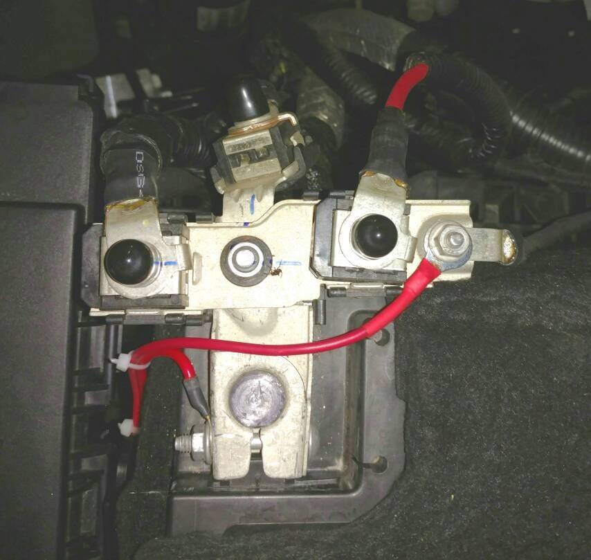

Looks like it is the 125A fuse that is built into the battery post. Its under the left side black cap in this picture. Does anyone know what this has a special name or if it is a dealer only item?
