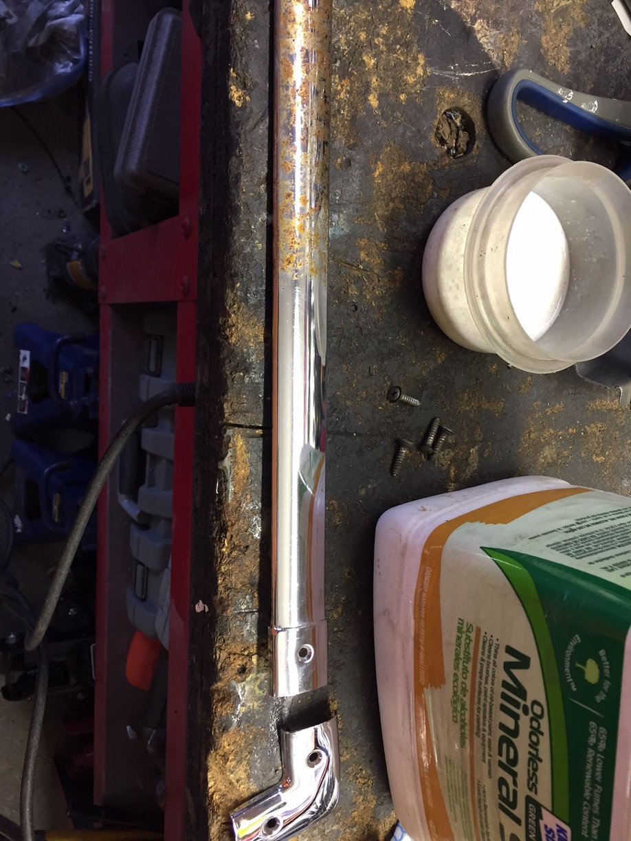

This might sound funny but make sure it's rust and not smoke tar....Here is my post about it https://www.ford-trucks.com/forums/1...2002-a-16.html I never did anything with mine for years because I thought it was rusted beyond repair and was going to have to sand and paint as well. I was cleaning the inside of my cab and by chance I got over-spray of the cleaner I was using on the trim and what I thought was rust wiped right off. I know it might be a long shot but it's worth a try. I pulled all my trim and went crazy cleaning it after I discovered it wasn't rusty. Anyway good luck hopefully you get as lucky as I did. The cleaner was "Black Magic Bleche Wite tire cleaner.

Man U got lucky! I've hit some of the better pieces with an sos pad and no luck!
