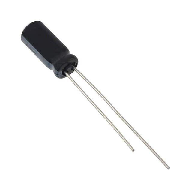

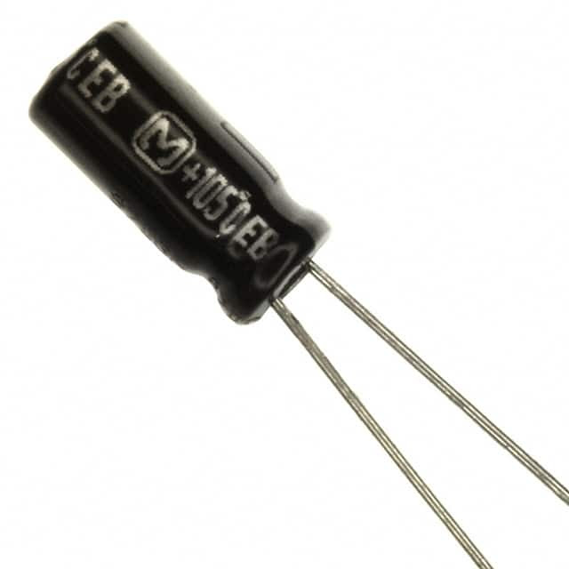

below are the capacitor values and part numbers. I had just ordered these for my 95 5.8 and E4OD but on closer inspection of the PCM board, found a lifted solder pad under the tantalum cap. I decided to go with a rebuilt in lieu of repairing. As far as hot start, i had previously read that your IAT (Intake Air Temperature) sensors can get gummed up with age and not respond as quickly. Cheap part to replace and easy to get to.DetailsAvailable QuantityBackorder QuantityUnit
Price
Extended
Price
EEU-EB1J100S
P13467-ND
CAP ALUM 10UF 20% 63V RADIALAvailable
Quantity
Backorder
Quantity
Unit
Price
Extended
Price
1000.19300$1.93
EEU-FR1E470
P14411-ND
CAP ALUM 47UF 20% 25V RADIALAvailable
Quantity
Backorder
Quantity
Unit
Price
Extended
Price
1000.21500$2.15
