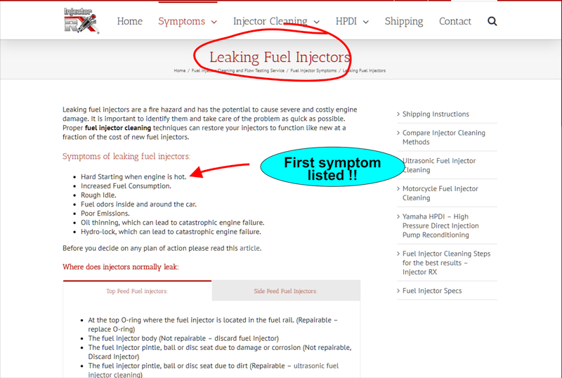

Good thoughts and research. I did a little more searching regarding symptoms and the "hard starting when hot" is at the top of the list for leaky injectors on multiple sites. I found what appears to be a good source for domestic injector remanufacturing and will probably replace them all with a flow matched set. They quoted a price of $135 with Ford cores. Plugs are hard enough to get to so I don't need to know which cylinder. This should match a noticeable difference on my poor mpg as well.
