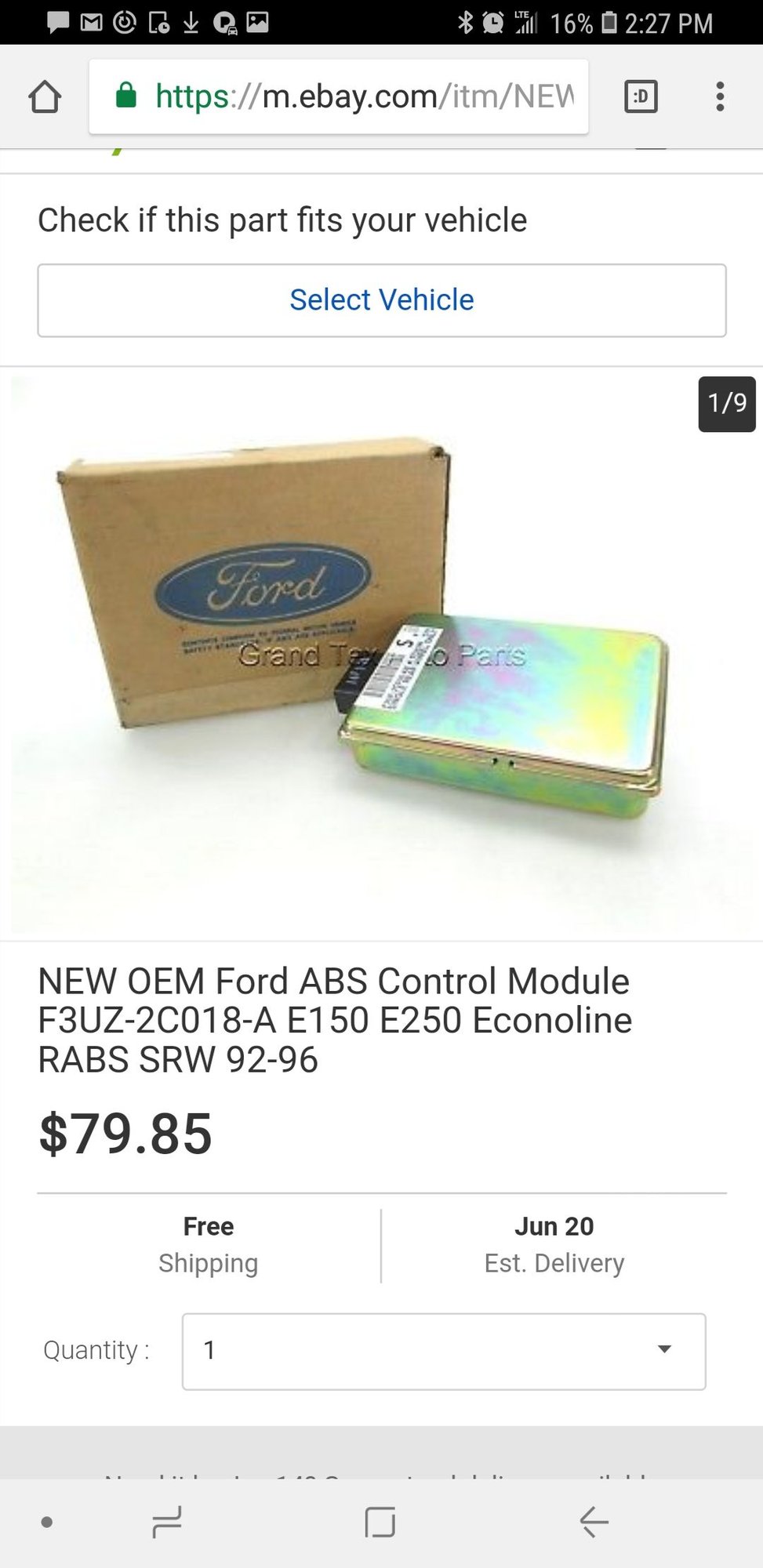

Try 80.00 new. Ebay number 1211113163

I just searched that number on eBay. Zero results.
Anyway, I'd be very leary of an eBay item that's less than 10% of what the same thing costs from reputable sources.
I was just looking for one for my 96 E350 a couple of weeks ago, and I was seeing them in the $800 and up neighborhood. My ABS light has randomly come on since I bought it with 16,000 miles on it. I'm the second owner.

There is a surplus of these modules out there. Stay with NOS and you will be fine. To pay 800 is nuts, Ford sold off all this inventory over 15 years ago for pennies on the dollar.
