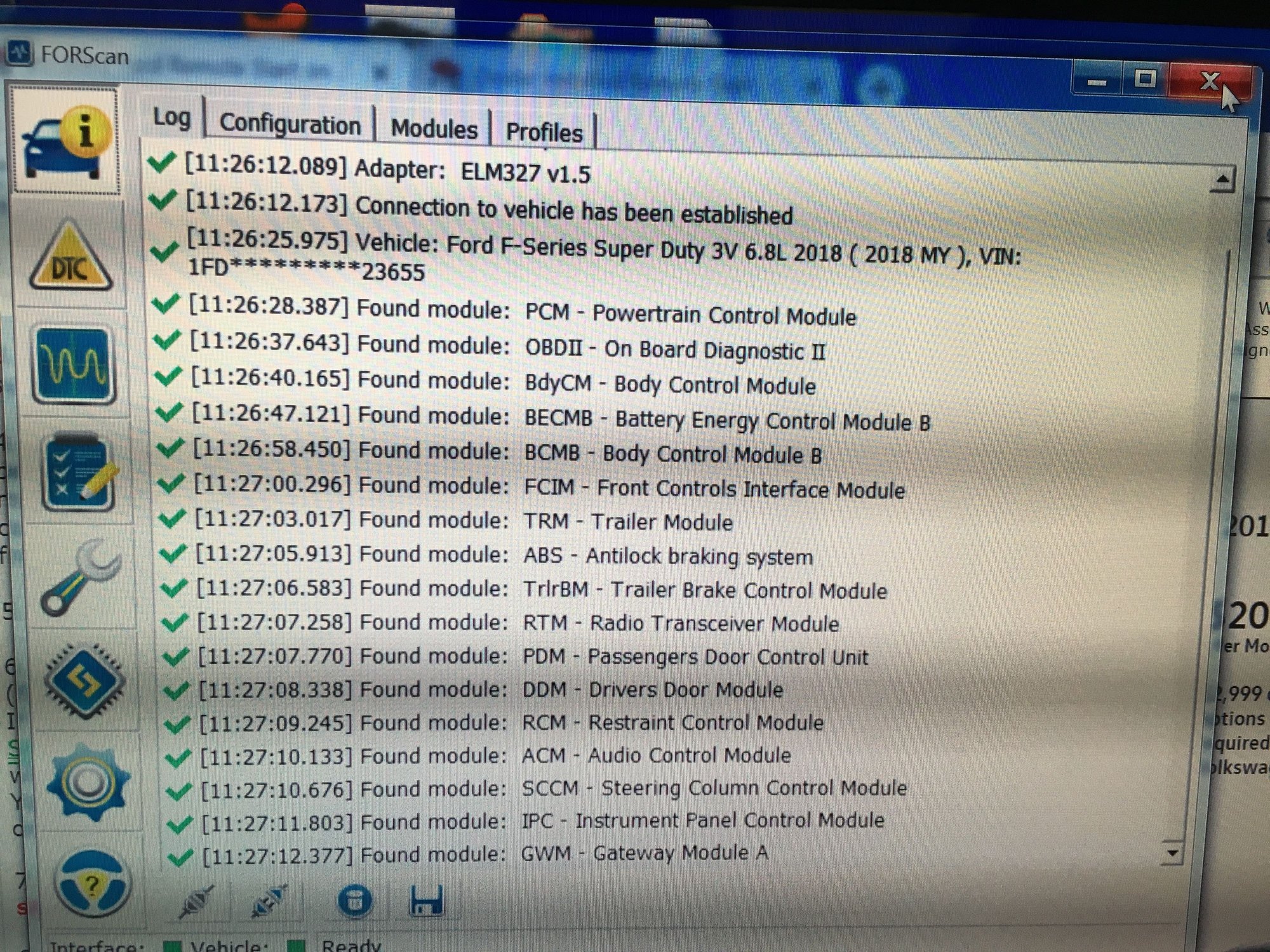

ok, forscan gurus. I installed the ford module as listed above, however, when i plug in and run forscan i am not getting an option for IPC module. I got the BdyCm and made those changes and remote start works. I just cant get it to come up on the dash to adjust the settings. Have tried the switch both ways on OBD2 connector...only my getting a few modules...any thoughts on why?
edit: i figured it out. Forscan had saved my incomplete scan as the profile. deleted profile and rescanned it worked.
