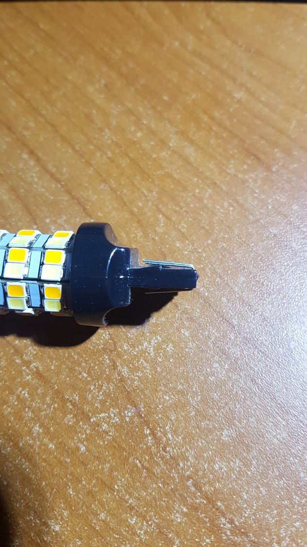

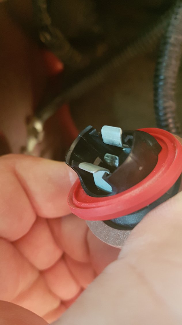

I'm having a heck of a time getting any to fit into the plug on my 2018 F350. I have tried 7443 and a couple others but they don't stay in. The clip doesn't hold onto the darn bulb. And these are from Superbrightled
In one of the other older thread on this subject, myself and another poster mention that we had to grind away a bit of material with a Dremel for a better fit. If I remember correctly, this seems to be an issue with several different brands of bulb.
Perhaps someone who has gotten a good fit right out of the box could post the brand they used.
