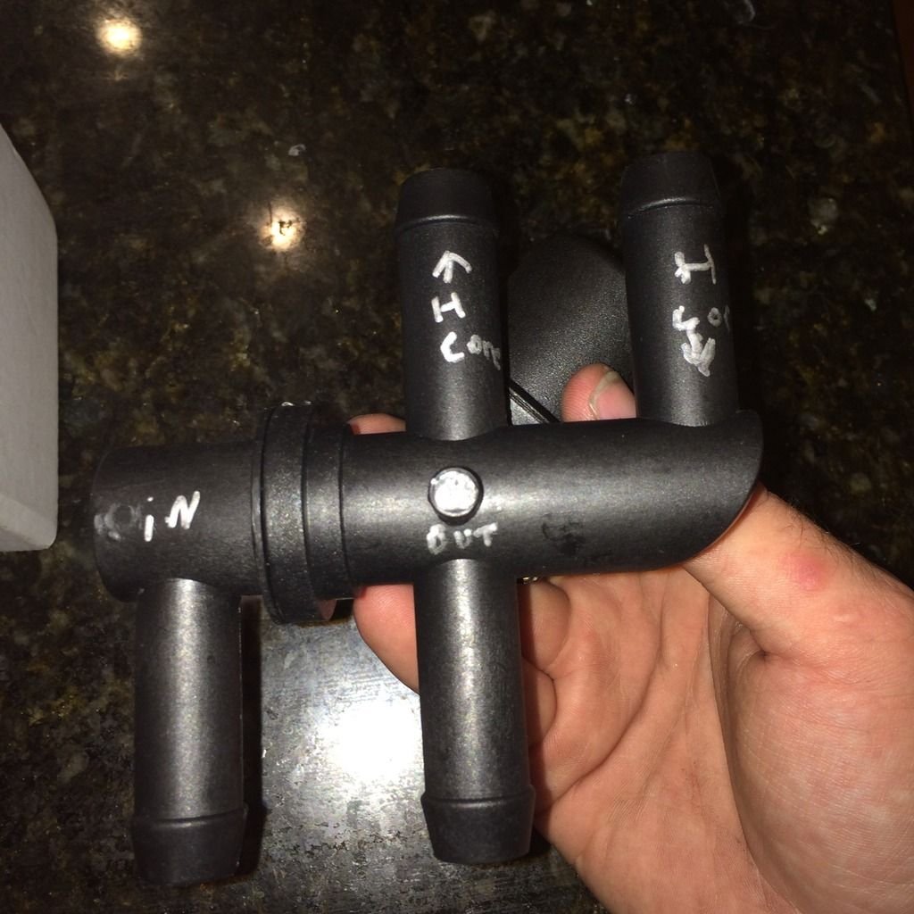

I had nothing but leaks while using the NON OEM Ranger valves. I installed an OEM Ranger valve and have had no issues for the last year or so.
As you know the Ranger valve is vacuum activated so if you start your truck prior to the vacuum pump building enough negative pressure (vacuum) to close the valve, which is not a problem in the hotter climates due to not needing to allow the glow plugs to heat, then, there is regular circulation for about 10-30 seconds after each start.
As to the ball valve, I was told to incorporate a physical bypass: think two "T's" with a short hose between, after the coolant leaves the engine and prior to the valve so that coolant could flow/return to the engine and not dead head.
The flip side of this argument is that provision does not exist on any of the factory equipped Excursion valves on Excursions that I've seen...single hose in and out of the valve....OEM Excursion valves effectively dead head for the most part.

and why must everyone over complicate things? yes its vac opperated but no dead head here....this was a ranger/excursion valve BTW....just sayin'
Old 05-09-2018, 10:42 PM
jhl3's Avatar
jhl3
jhl3 is offline
Join Date: Sep 2014
Location: Asheville-where weird is
Posts: 2,404
jhl3 is a splendid one to beholdjhl3 is a splendid one to beholdjhl3 is a splendid one to beholdjhl3 is a splendid one to beholdjhl3 is a splendid one to beholdjhl3 is a splendid one to beholdjhl3 is a splendid one to behold
For clarification, actually, the above picture represents the Ranger valve which does not dead head the coolant flow prior to the heater core and does provide a return path from the head to the water pump which is why it is preferred by many.
Below is the Excursion valve which does dead head coolant flow to the heater core which is a concern for some but evidently not for FORD....hence, some installing a ball valve only. Each person has to make their own decision on their own truck at the end of the day and live with the results be they positive or negative, real or perceived. IIRC, both have a small hole that allows a very small amount of coolant to flow which would be insignificant as to cooling for the engine. The ball valve, if fully closed, would not allow for this.
Any of these approaches leads to much cooler air in the A/C vents.
