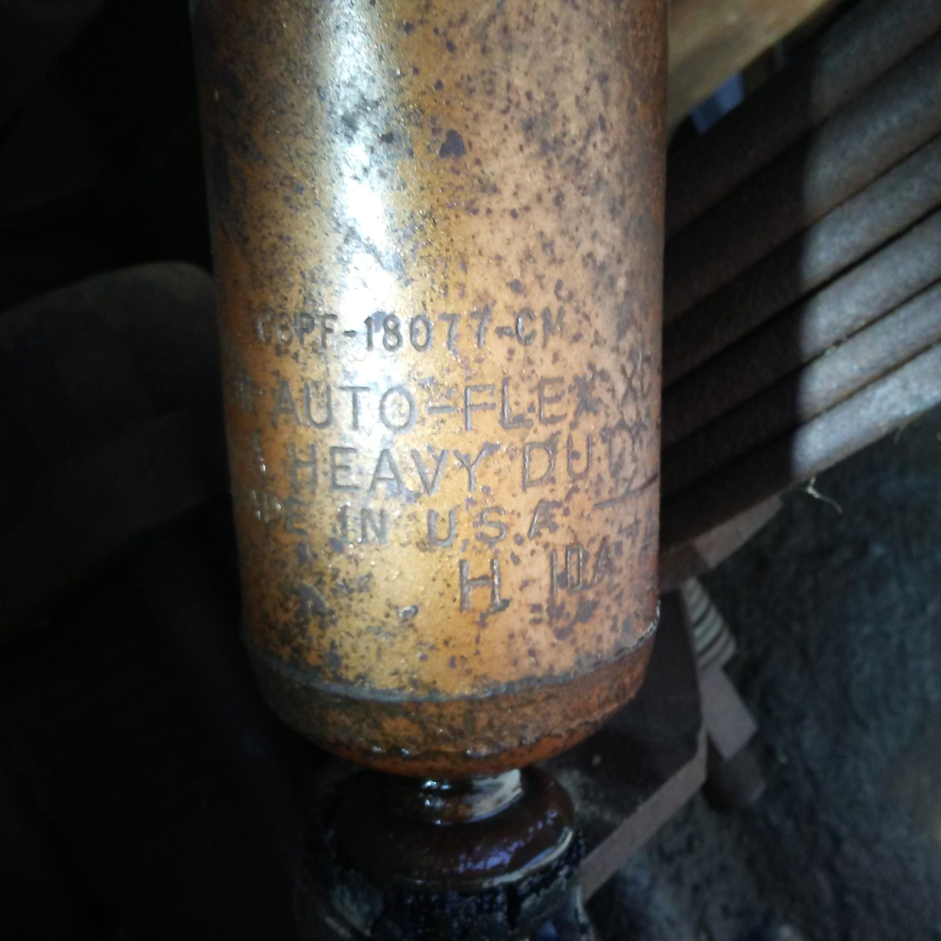

Replacement Shock; C6PF-18077-CM
1962 Ford F350 4x4 Napco
Motorcraft
Auto-Flex XD
Heavy Duty
H 10A
We are trying to ascertain an appropriate replacement shock...
Research points us to the following;
Monroe
34803
83312
83314
Close, but we believe we don't get a cigar just yet...
If anyone can steer us down the correct path [correct shock options] it would be greatly appreciated!

C1TZ-18124-J .. Auto-Flex Xtra Duty Front Shock Absorber / Marked with ID number: C6PF-18077-CM (Motorcraft AX-72) / Obsolete
1961/64 C550/600; 1961/67 F350/600
MILLER OBSOLETE PARTS in Binghamton NY has 1 = 607-722-5371.
MCDONALD OBSOLETE PARTS in Rockport IN has 2 = 812-359-4965.
