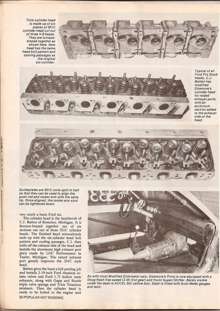

Mary-Kate Here are some of the recent "treasure trove" discoveries I have unearthed from among numerous magazine articles [containing published technical info] that are insync with what you requested and a "National Dragster" rag mag series started in the 90's entitled "Where are they now?" to give you a better sketch of my background. Note date, something more recent LOL Oct 25, 1996.
The PHR and Hot Rod Mag articles contain all of the technical details of engine & chassis configurations for my “Pro-Stock Six” Pinto as of late 1974 & early ‘75. These very comprehensive articles occurred prior to my 9-second ride achieving National notoriety status, with subsequent NHRA Championship titles spanning 4 years.
The Car Craft H/MP comparison article with Glen Self’s 292 Chevy was given to me by my son-in-law last May when I made my “for the project” trip to Michigan to acquire much needed Ford OEM blueprints of the 240/300 engine circa 1968 & 1973. Forum members at large, currently, contemplating significant performance improvements, with either the U-Flow or anyone’s cross flow head, could benefit by incorporating these engine build tips and techniques into their overall plans.
Collectively these (3) Magazine articles contain all of the salient details necessary for success. NOW, imagine combining these 45 y.o. build techniques with today’s readily available aftermarket parts/pieces + numerous new offerings our TEAM will be producing for even the most demanding 4.9L HP/Torque needs.
In closing I will encourage ALL interested parties to this imperative research and development project, to stay tuned. Remember to: keep the faith, pray for our successes, respond with your ideas, constructive criticism is encouraged, NO requests will be trashed with indifference, YOU are our primary concern and valued audience. Bruce
