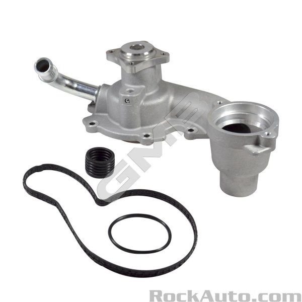

Correct, the pump is external like most other "normal" designs. The 2.7L V6 has absolutely no commonality with the 3.5/3.7L engines, which is what led me to dig into this further. Here's the pump:

Yup, I checked Rock Auto first and it listed a common pump for the Edge and the F150 applications! I did drive a CPO MKX with the 2.7 Ecoboost and 22 way power seats a while back and was not in love with the seats but LOVED the engine. Boy did that vehicle haul butt... I believe the MKX has a higher hp rating than the Edge (335 vs 315) in 2018 and earlier models...and the Edge is gonna get the additional power and an 8 speed auto in the new ST version for 2019. That will be really tempting but discounts and rebates will not be high for a while. But it should accelerate like my old late 60's musclecars and will let me have my 2nd childhood while also getting a practical and useful vehicle. Make that my 3rd childhood as I just had my 3rd 22nd birthday...or was it my 6th 11th birthday?
