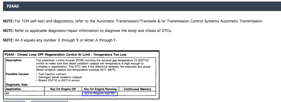

My alldata is not showing a P0170 either strange...The P24a0 is attached.

It's a code with many possible failures. Here is a cap from the 2016 service manual.
