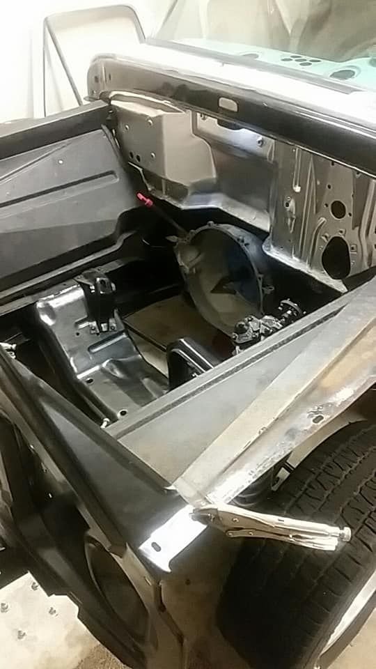

So, my son and I finally pulled the engine and broke it down today. Any day in the garage with your kids is a good day. It turns out that I've got 30 over block with 4 valve relief cast pistons. The crank is a C1AE-A cast and we're not sure about the rods yet. The cam was a FoMoCo with the stock Phillips-head screws in the retainer. It also had a link-type timing chain with a lot of slop along with stock non-adjusting rockers. The way it was all assembled makes me think it wasn't a Ford guy that slapped it together and the varied part combination has me worried. Not to mention that they used a lot of bottom dollar parts and lots of RTV on everything. Either way, I'm glad we pulled it before it got a chance to spit out parts on it's own. On the bright side, the cylinders looked in good shape with crosshatch showing a bit. A couple questions though- is it normal for the oil galley plugs not to flush with the block? Also the rear cam shaft expansion plug seemed to be installed backwards compared to what I'm used to seeing; any thoughts on that? What else should I look for in particular to FE before I make any moves on this engine? Thanks for your time!!

Lots of hours, dollars and beers later.....engine turned out to have 360 rods with "truck" 390 pistons on the 390 crank. It's getting bored another 10 thousandth to 4.090; refurb 390 rods with ARP bolts, Speedpro forged flat tops and the jury is still out on the intake, cam and head combo.

Current fun being had is the drip rails.

Lots of progress over the winter and the weathers getting better. Hopefully have the glass back in the cab and transmission permanently situated with notched crossmember, AN6 cooler lines, converter and set the short block in the frame rails finally.

We got the short block, stall converter, transmission and new deep sump trans pan put in the frame this weekend. I went ahead and set the heads and intake on just for motivation until next weekend.

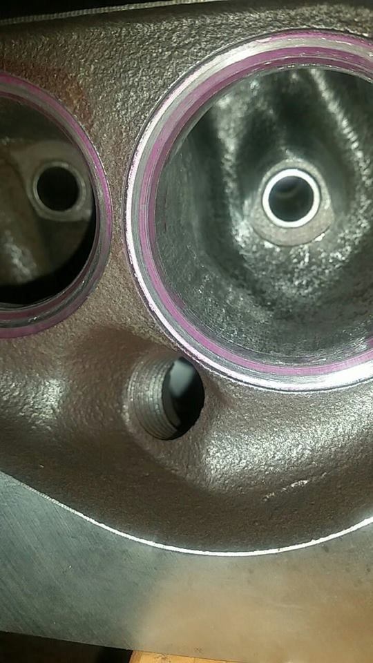

I have the 2291F pistons with C8AE-H heads with a bit of port clean up and I chose the Comp XE274H cam. The rear end currently is 3.0 but I wanted to see how the engine idles in gear with my Hughes 2500 stall C6. I'm basically building this truck from front to rear so the gears can go either way as long as it makes me smile every time I hit the throttle. Only thing I'm not solid on is piston to valve clearance with stock non-adjusting rockers and Comp 9.621 length pushrods.

That's a good sporty cam for a daily driver but pretty mild for a single plane intake. You might want to reconsider that big intake. There's a good chance you'll have problems with an off idle stumble and low end torque with those highway gears and mild cam. I think 3.50 gears are the minimum for good seat of the pants feel on acceleration. If you had an OD trans I would bump that to 3.70s.
I had a big hyd roller (around 520/530 lift) in my Mustang with a single plane on a 408 Windsor. I had to rev it up quite a bit to take off from a stop light and that was with a 5 speed manual and 3.70 gears.

My original intent was to NOT use an Edelbrock but finding vintage FE intakes that aren't trashed is pretty challenging outside of having Southern California swap meets. I had the pleasure of meeting Denny Aldridge because of this. He has his shop a couple hours away in Washington and he has decades of FE wisdom and parts which is where I got this intake. I have a 4 hole 1" spacer to help with the open single plane a bit and should be able to tune out any stumble later on with jets and squirters. Hopefully anyway. I chose the Comp 274 based on Denny's guidance towards my wanting a nasty idling cruiser rather than a top end build. It is a heavy truck after all. I really just want to solve my piston to valve worries for now. If my parts combo doesn't work out, it just means more time in the garage. lol! This is my first FE build so I know I have a lot to learn and any input is appreciated.
