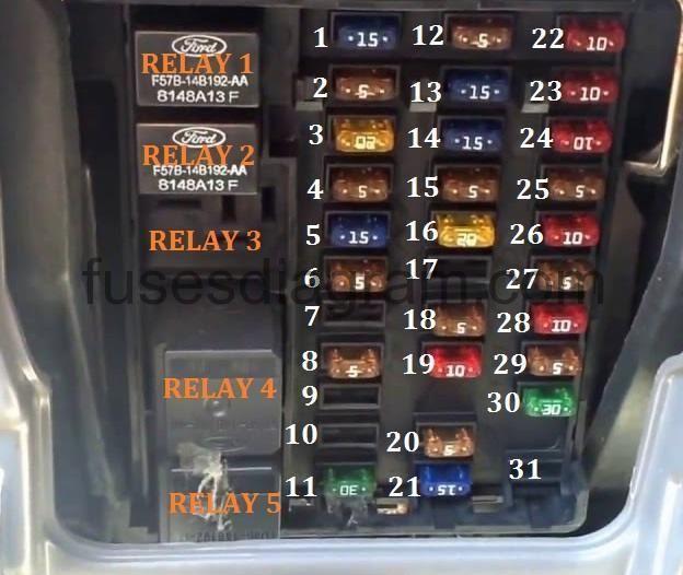

Originally Posted by pdqford View Post
After swapping relays, if the CEL doesn't light at KOEO, how can it start?
Did the CEL lamp come on at KOEO?
Did you check fuse #30 in the Junction Box under the IP?
The truck still does not start. CEL does not light up with key on engine off, and it does not light up when I try to crank it (key on engine on).
I checked fuse 30 and it is fine. Is this the 30 AMP fuse #30 you are talking about under the dash in this picture?
Thanks,

Old 03-19-2018, 04:59 PM
pdqford
pdqford is offline
Join Date: Jan 2001
Location: Central NYS
Posts: 3,095
pdqford has a good reputation on FTE.pdqford has a good reputation on FTE.pdqford has a good reputation on FTE.
Question
