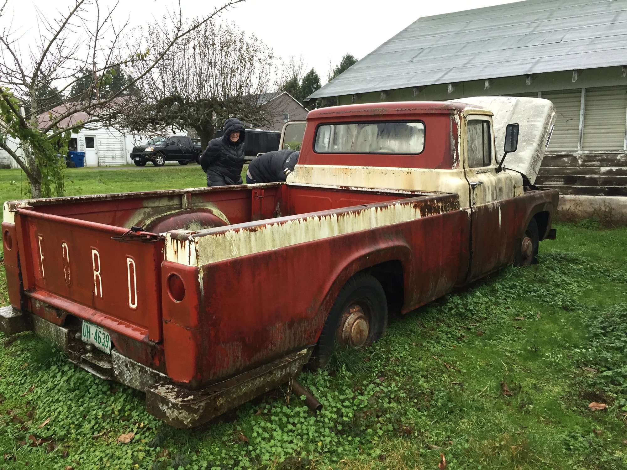

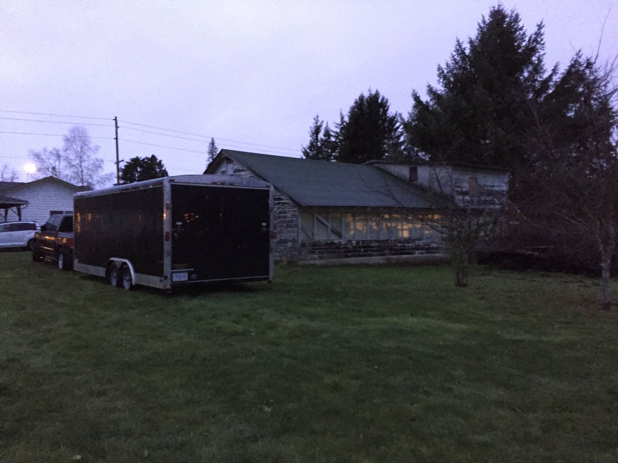

Hi everyone, Iím Duaine and Iím from Vancouver BC. Iíve been a member for a year and I guess itís time talk about my build. I bought the vehicle just over two years ago from a very nice older woman in Kent Washington and hereís some pics of it the day I picked it up😁
