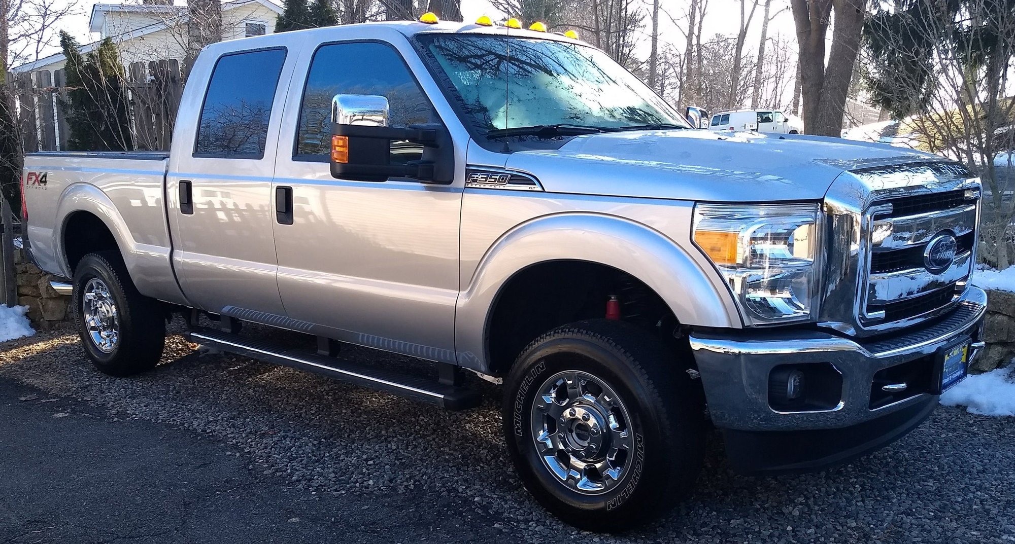

FordmanNJ's New to me 2016 F350 XLT Thread
Hello FTE,
Back in late January my beloved F250 was involved in an accident. Unfortunately the truck was totaled and the insurance company paid out. Once the dust settled, I went looking for a new truck for a replacement. My wife found this one. It's a 2016 F350 CCSB XLT with premium, Fx4, 5/GN, Snow plow prep Chrome packages. The bed has spray in bed liner. 4 wheel drive with ESOF and is geared as 3.73 Elocker. The tire package is LT275/70/R18 Michellin's. The radio is stand Am/FM/Cd but with Sat Radio. The color of the truck is Ingot Silver.

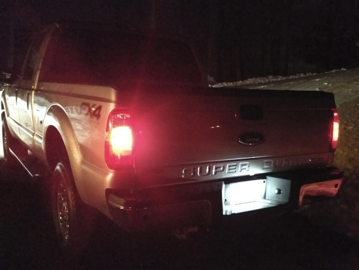

At this point I had to stop as I didn't have the bulbs I wanted for the rear. Since my wife needed to run out, I would price check a local source in this case Advanced Auto since it was on our route to Amazon. The couple of dollars of savings was not as great for waiting another couple of days, I just bought them from the store. These were the tail light bulbs. I forgot to order them when I placed the order from Amazon. I went with the Sylvania LED 3157 Red since I had a great experience with the Ambers in the front turn signals. Originally I was going to replace the 921 reverse lights with T10s White LEDs but I remember them being bright but not super bright. I elected to check out the ZEVO line from Sylvania. Reviews reported a nice bright light and good overall experience. So those where going to be the replacements for the reverse lighting.
The wife and I returned from our errands. Light was fading fast even with the extra hour of daylight. I removed the tail light housings from the truck. I used an 8 mm socket to remove the screws and a plastic body moulding tool to remove the housing from the truck. I removed the bulbs from the housing and replaced them with the LEDs I had just purchased. I made sure the polarity was correct and performed a test of the Reverse lighting and turn signals. All tested good. Reinstalled the housings to the bed and performed a walk around turn signal and 4 way test. All LEDs were functioning correctly and no weird issues. Finally I replaced the Rear license lighting. My friends T10 White LEDs were there for the replacement.
With light now fading quickly I tried out the headlights. Right off the bat, I could see a great deal of difference. The light was crisp and white. They looked right at or may be a hair low however, I would have to take it out for a night test run to determine if any adjustments would need to be made. I also checked for RF interference. When I live in NJ, I am able to get several FM stations out of Philadelphia and New York as well as the local FM/ AM channels. I know in the past, there was always some form of RFI from HIDs which I loved the light but hated when I was not able to tune in the radio. My first set of LEDs were better but you could get the static when the headlights were turned on. These new bulbs had very little if any when turned on. Low Beam. High beam. Fog lights on or off. No static coming from the radio. That's a good thing in my book.
After taking care of some family time, I took the truck out for a test run. Some local 2 lane back roads, a main drag and then a 4 lane highway. Since I do not have a wall to check the alignment against, I took the truck to the local school. When I checked the wall, the bulbs where sitting at nice level and even at 30 feet from the wall. Then I drove around and lighting on the road was excellent. I checked to see if I was lighting up the cabins of on coming vehicles. No flashing of the high beams or anything. Down a dark road, the lighting looked great. Even and dispersed well. The busier main drag was the same thing. No one seemed to have an issue. The same was true on the highway. The test ride seemed to be a success. It was worth the time and money to upgrade at this point. Now I know the crowd likes pictures so here are some.

Back from the test ride. Just a nice front view of the truck with the new lighting.
Driver's view of the lighting. This is low beams and IIRC foglights on. The street I took this on is nice and dark. I think the snow and some of the road salt is amplifing the light in the picture. However I had my old 2011 with HIDs down the same street and the lighting was the same.
A shot of the rear of the truck. Looks good.
