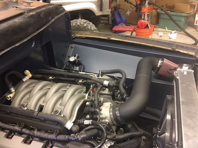

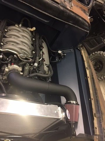

CharlieLed has a brilliant futureCharlieLed has a brilliant futureCharlieLed has a brilliant futureCharlieLed has a brilliant futureCharlieLed has a brilliant futureCharlieLed has a brilliant futureCharlieLed has a brilliant futureCharlieLed has a brilliant futureCharlieLed has a brilliant futureCharlieLed has a brilliant futureCharlieLed has a brilliant future
The shop I am working with made up a set of inner fenders out of aluminum for a buddy of mine. Here is a pic showing his truck as he gets it reassembled. The shop stretched the top edge of the inner fender panel to give it a little arch...the gap is almost nonexistent but the aluminum is a little flimsy. I think that a stiffener strip is needed where the inner bolts to the outer fender. This inner fender design is not one that any of the aftermarket vendors sell.
