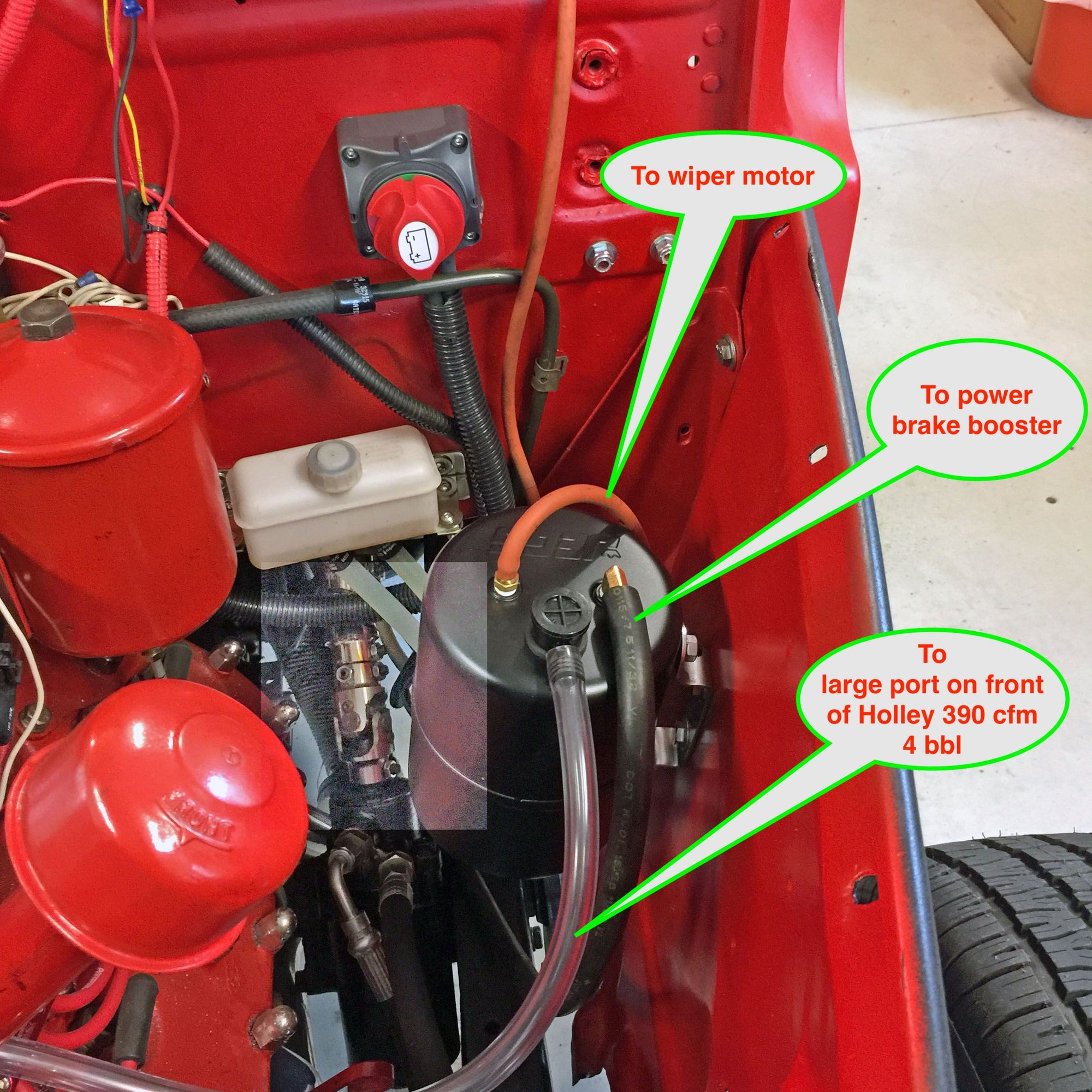

Just add a vacuum tank. I think that I got this one from JEGS.

If I remember right, the Wiperman says he tests rebuilt units at 14 inches of vacuum. A couple years ago I figured out how much volume was required to run the motor. I used the approximate internal dimensions of the motor, frequency, and high school level math to figure demand. I have no idea what I did with my figures or I would share. FWIW, I built a reservoir from four inch PVC pipe that will give me 14 full swipes of the wipers with the engine turned off. My reservoir is either 3 or 4 feet long.

Any junk yard/you pick will have those tanks for a dollar or two. Late sixties through early eighties chevy products are easy to access and remove. They look like a plastic ball.

Just make sure that it has a check valve.
