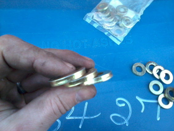

I agree with most all you posted except for this. I've had many washers curl on my manifolds under normal torque and conditions (even multiple stacked washers), and have had to replace them. The manifolds are cast iron, so they're plenty hard.
I eventually went with grade 8 thick washers from here and have been very happy with them.
https://www.nutty.com/EXTRA-THICK-Gr...ers_c_427.html
I got a mix of the 9/16" and 1/2" washers and pick and mixed as I installed them. The 1/2" give a nice wide area of clamping force, but don't fit on all of the studs (especially the ones underneath) due to the area available.
