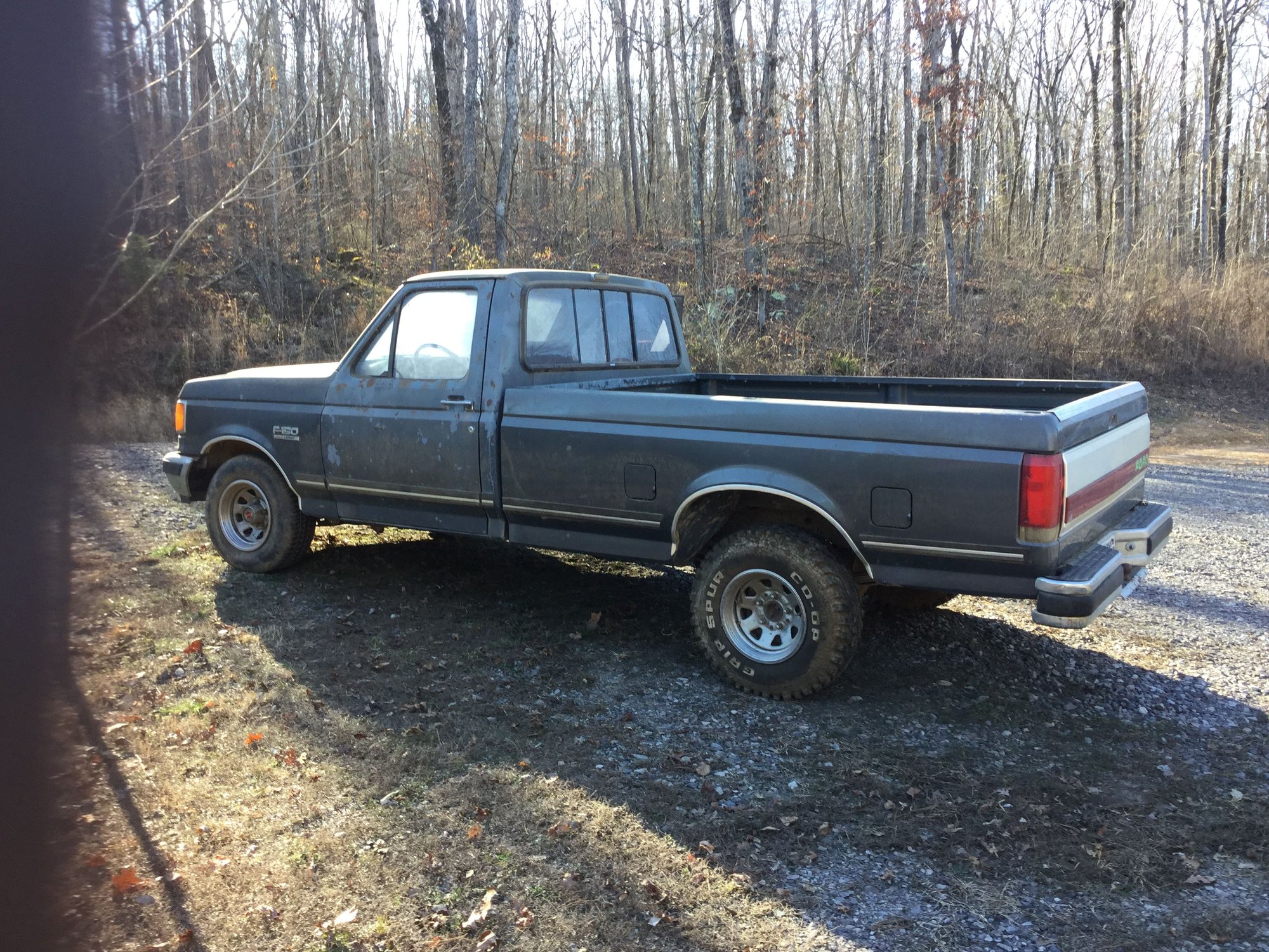

as she sat
worse than it looks - LOL
Condos were for lease here

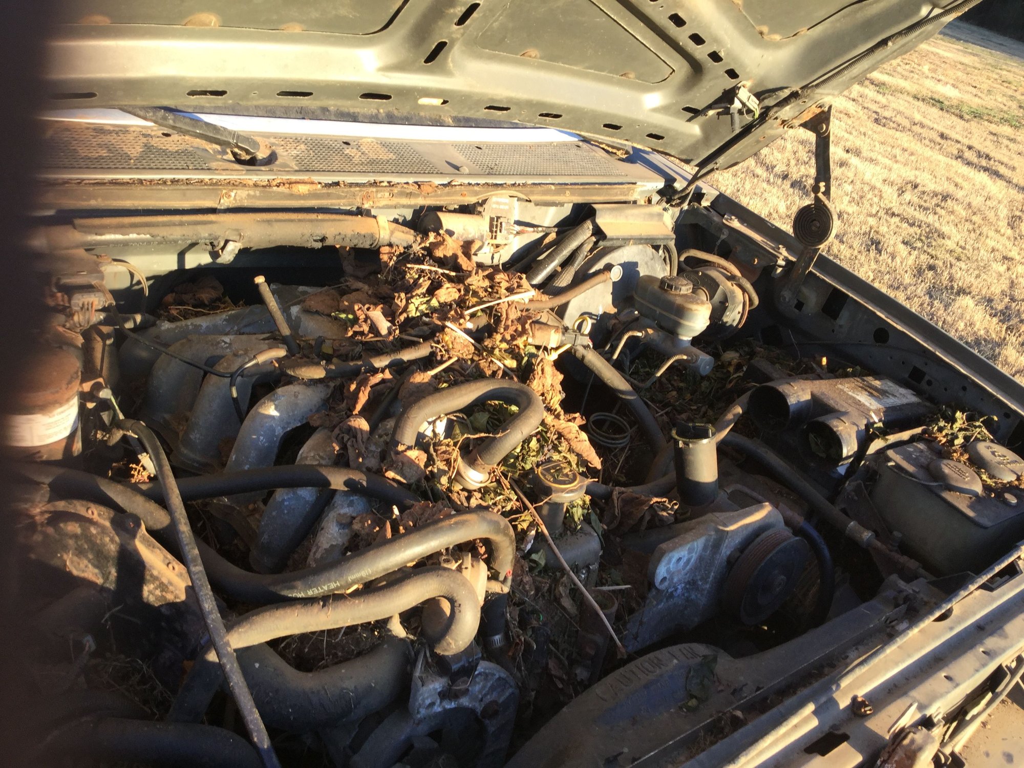

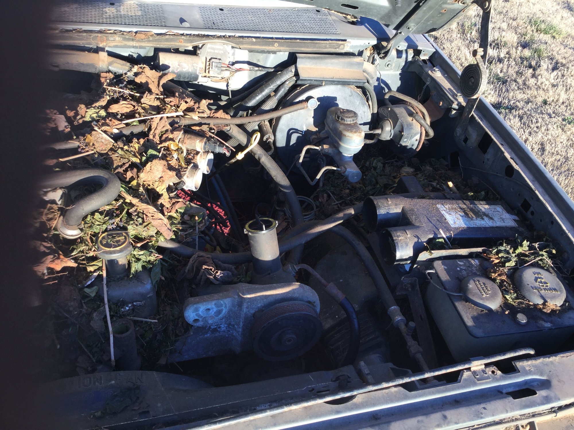

Looks like it'll take two rounds to get to the bottom of this...
Probably get the blower after it tomorrow after I tape a few of the openings up
There is more evidence of some wiring after i dug a little, hoses must be tastee cause they were devoured in a few places
The lacquer odor was heavy, and front tank had a do not use tag and leaked, confirming tanks and pumps etc.
Fun stuff. Like the overall stance and body style, so not discouraged.
