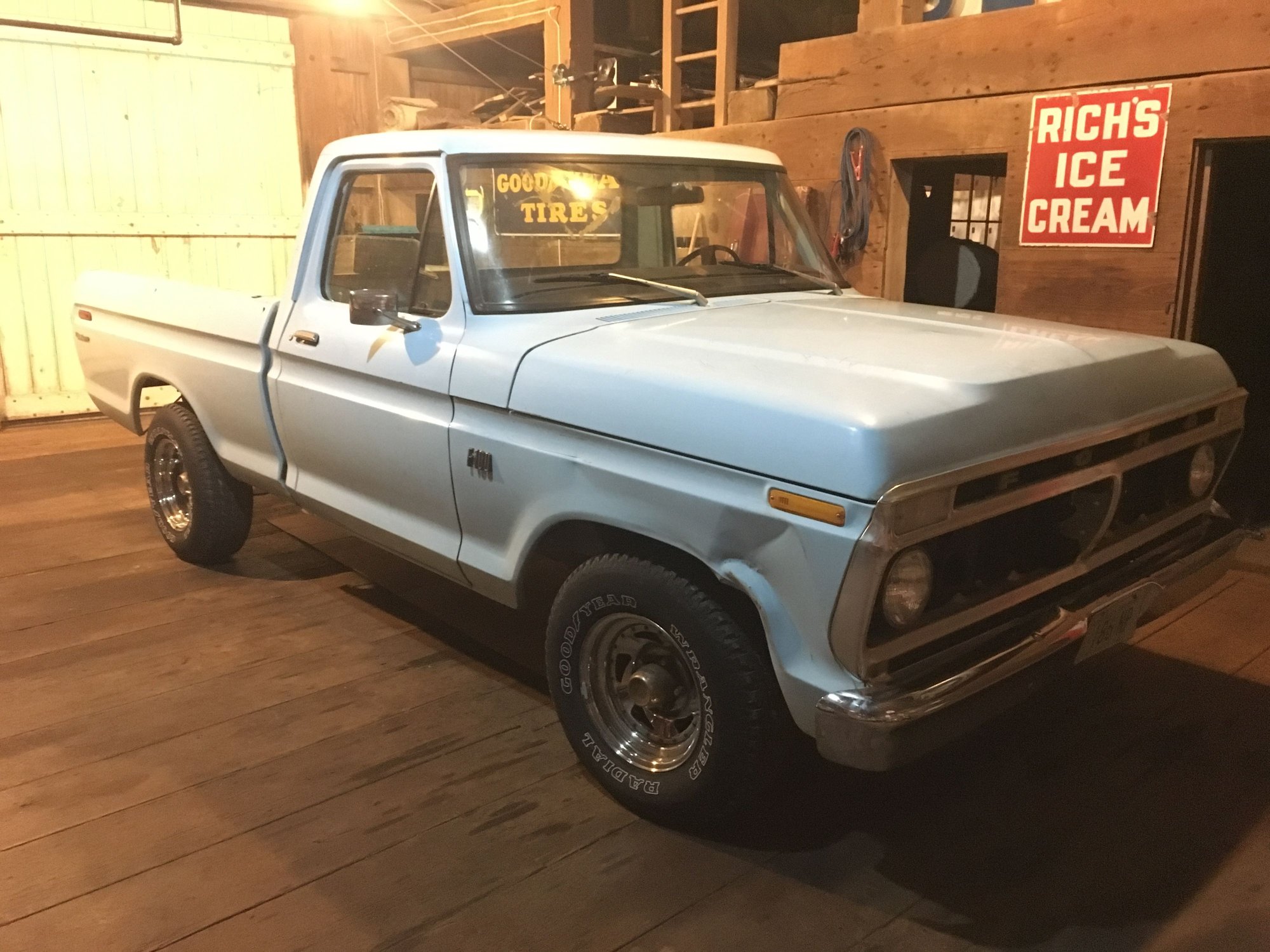

Thanks, i'll get some pictures up.

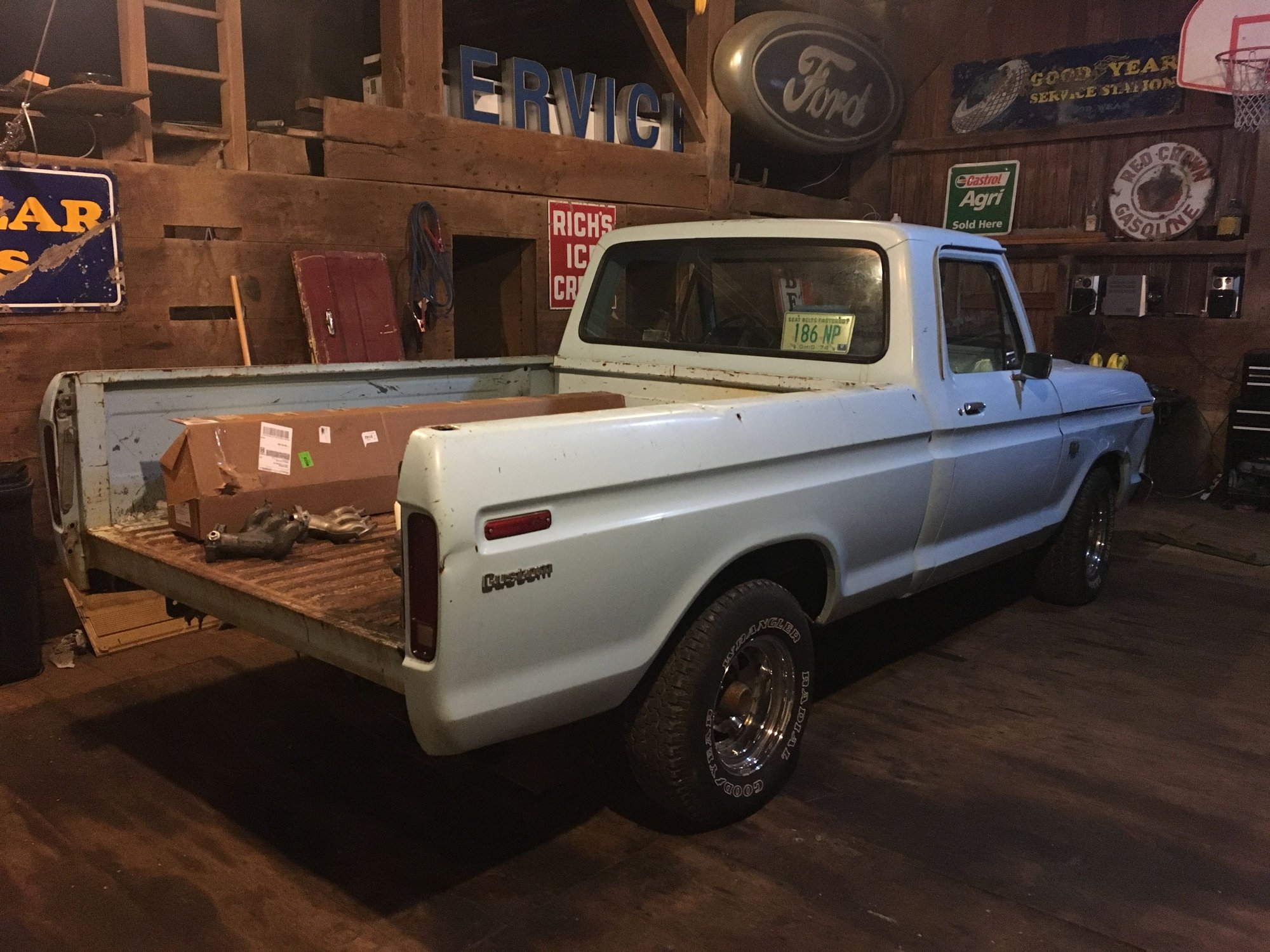

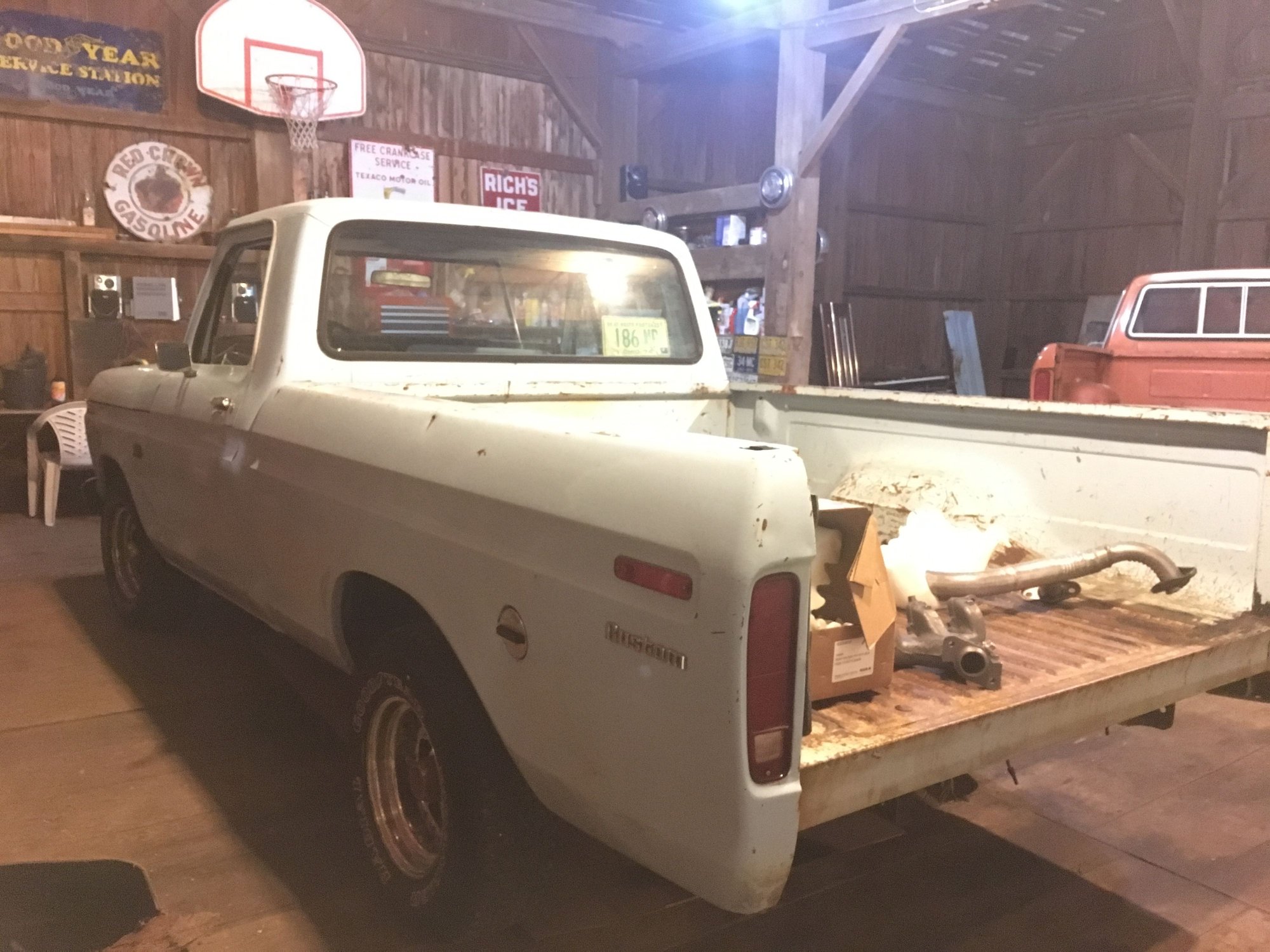

Have a front fender to replace the dented one.
Tailgate was dented. Luckily I also had one sitting in the barn.

And as for exhaust, Already have the EFI separate manifolds, can see them in the bed.
