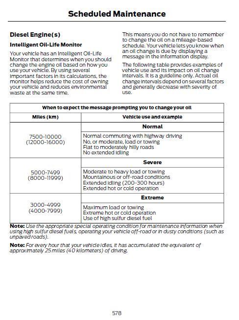

Many change the oil on 8,000km or 5,000 mile. Some change the original oil early, approx 3,250km or 2,000 mile. I didn't change the original oil til 8,000km or 5,000 mile. I believe the owners manual will tell you 12,000km or 7,500mi. You can also wait till the "Intelligent Oil Life Monitor" notifies you it is soon time to change oil.
Page 578 of your 2017 Owner's Manual...
