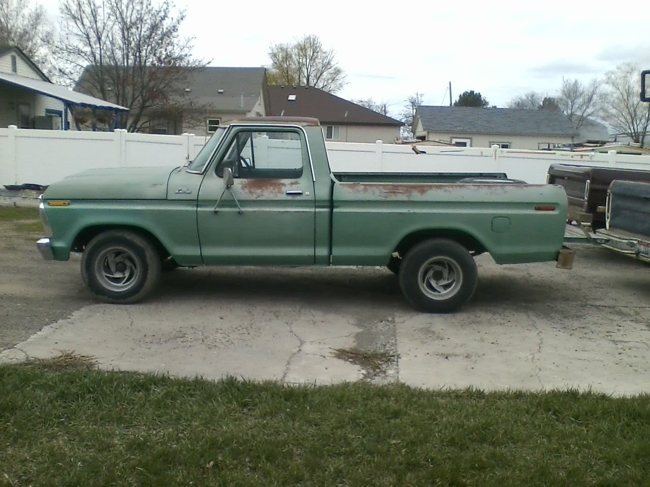

As for moneymike's question, I have 30" tires on my '75 F150. My F100, before I lowered it, had the common 235/75r15 size on it which is about 29". They both have/had fairly large gaps. I think they both had about 3" gaps on the front, from the top of the tire to the lip of the fender.
Here's the F100 with the 235/75r15's (29"). I would imagine 31's would have filled up the wheel wells pretty good had I gone that route. 33's might fit, but it looks like it'd be a tight squeeze up front.

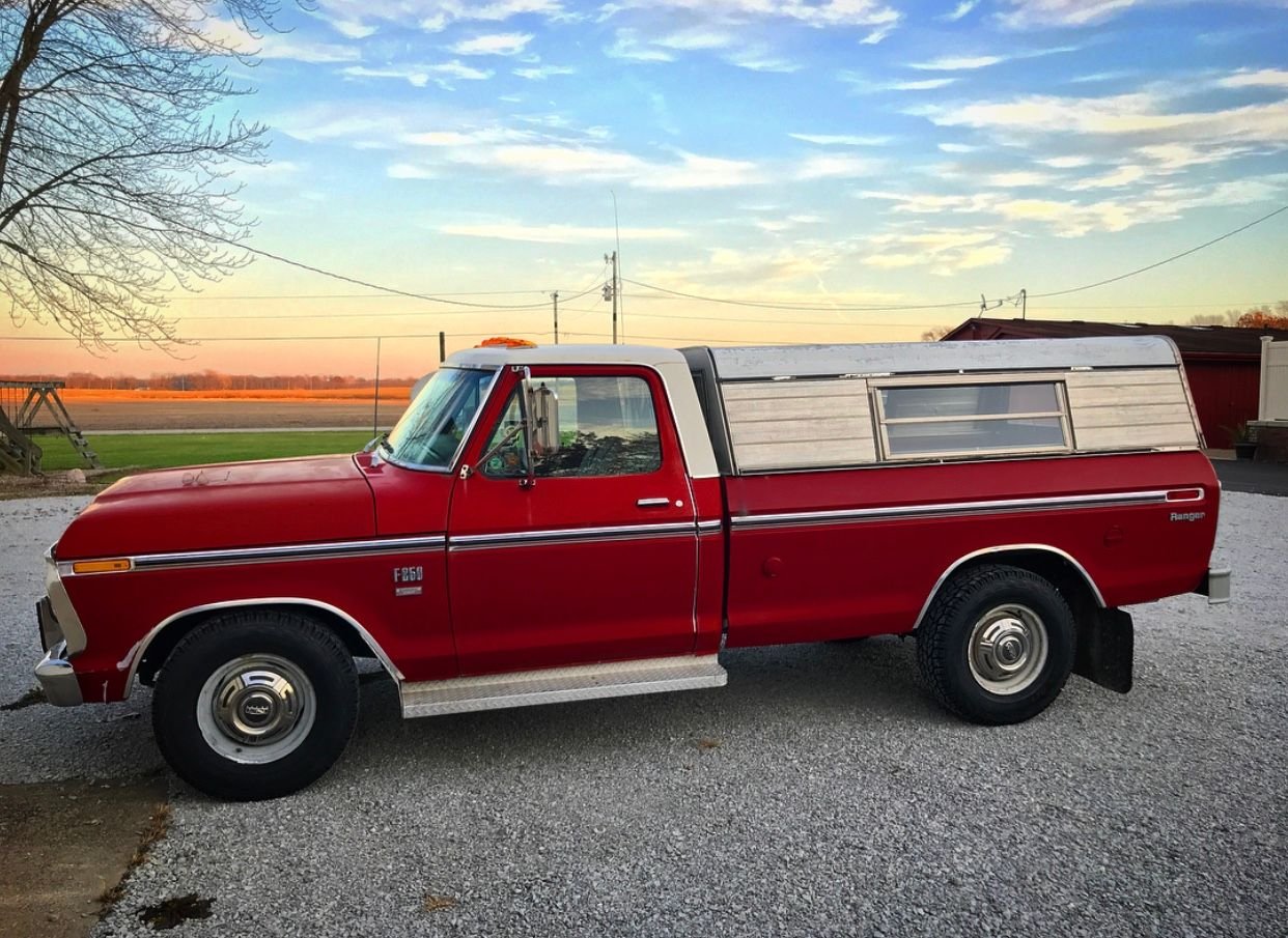

I just replaced rim and tires on my 1975 F-250 Ranger Camper. Made the switch from 16.5 rims to 16 and fit Cooper 265/70R-16’s. I wanna say they are about 31” tall and 10.5” wide. They fill the well nicely.
Fyi..... The wheels on the truck pictured above are directional. The rear wheel should be mounted on the passenger side.
You forgot the
If I get a copy of photoshop I'll fix it.
