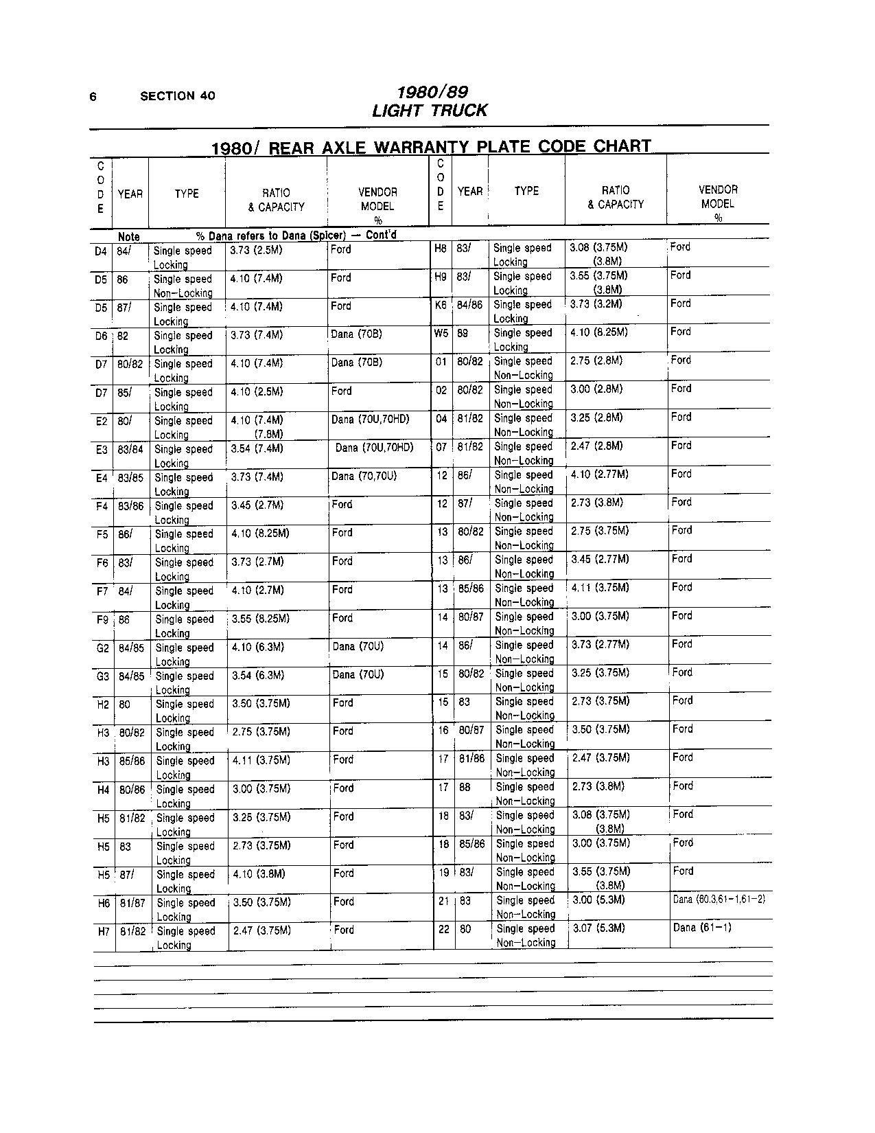

W5 axle code is 8,250lb 4:10 gear ratio limited slip axle.

OP says his '89 F350 4WD has a 11,000 lbs. GVWR .. but this GVWR is not listed in the 1980/89 truck parts catalog.
OP: TYPE/GVW listed on the Certification Label, post what the code is. This is the same label where the W5 AXLE code is listed.
Pic: Column right, 4th entry: W5
